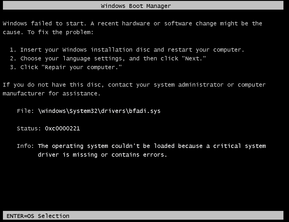

I moved to a new server, an R720 vs an R710 like before.  I moved all data over, and used the same USB, just created a new array.  Now, I am unable to create a Server 2016 VM.  Windows is no issue.  It does install properly, and I go through everything to the desktop.  Then, when I reboot, it fails and gives me the screen I added with the files.  Then, if I make a change to the VM under edit, either moving to another NIC, or adding a virtual drive, whatever, it fires right up.  Then, when I reboot, I get the same screen you see, again.  Does anyone have any ideas as to what I am doing wrong??
Anyone?
This looks to be a rather idiosyncratic problem with Windows and not Unraid. That file looks to be some HBA controller driver according to Google so I would suggest you rebuild your install media and reinstall Windows from scratch.

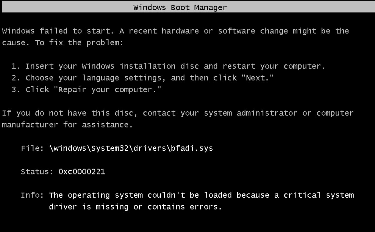

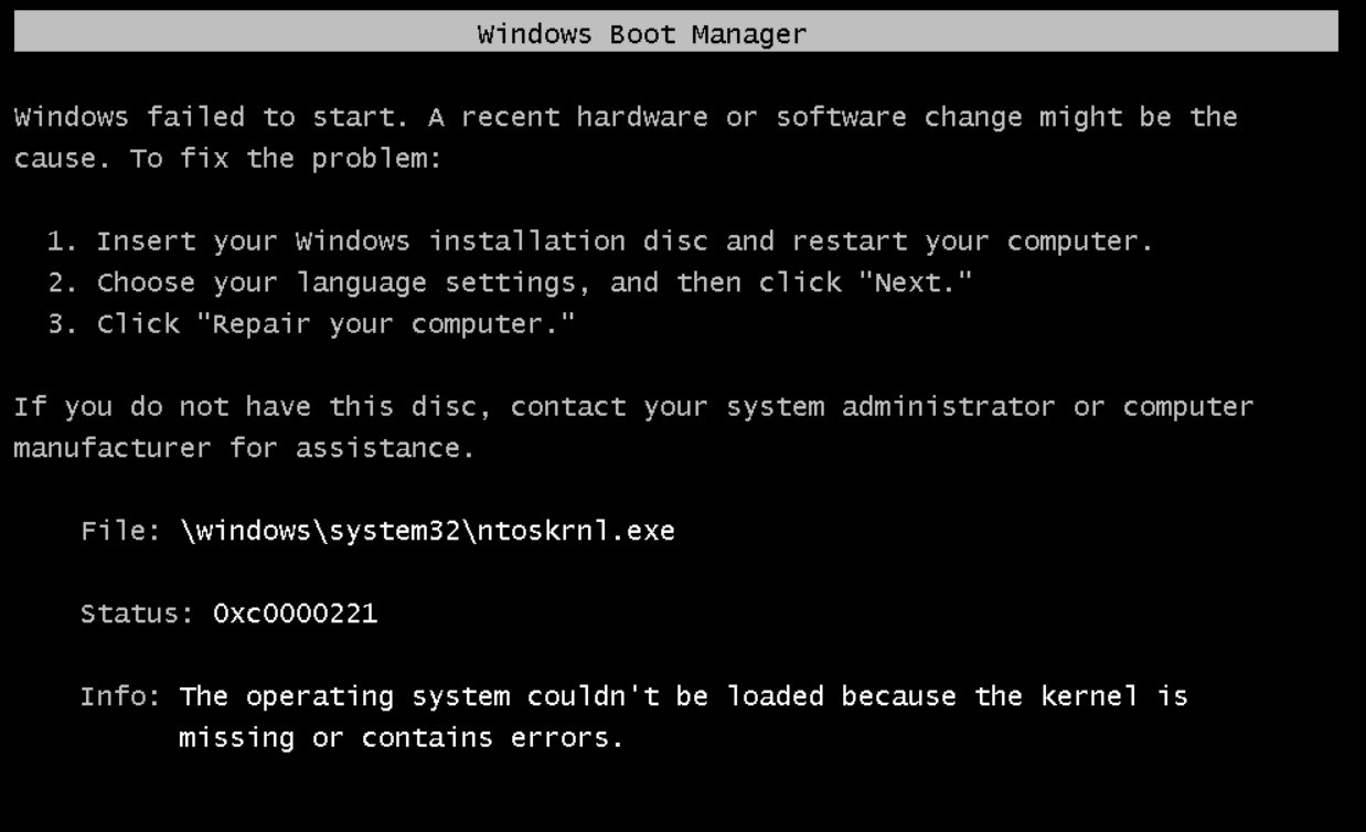

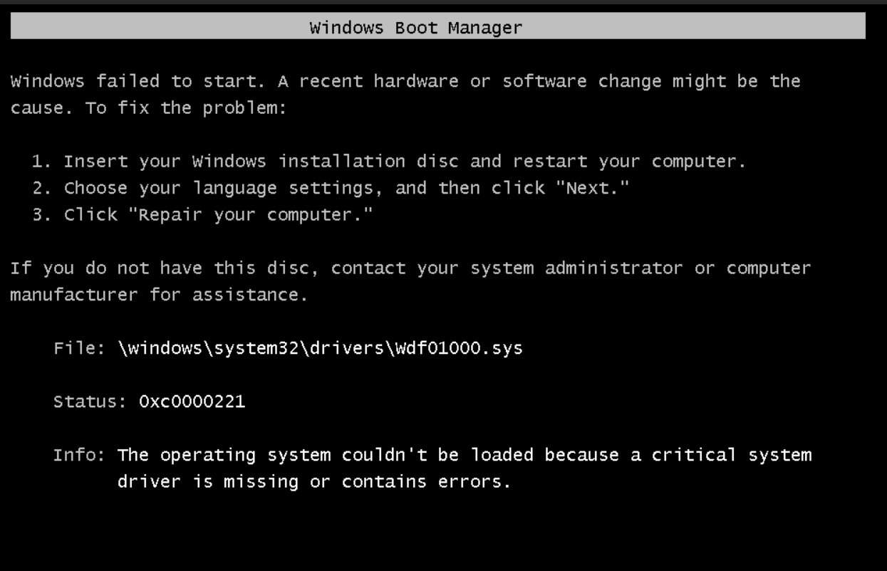

So just an update on what I have tried.  I have redownloaded Server 2016 and also Server 2012.  They both are doing the exact same thing as you have seen above.  I completed deleted my libvirt file and started over from scratch.  I have pulled all my NIC cards, no change.  I swapped my H310 HBA for an H200, no change.  I have included more screenshots, as the file changes on every reboot.  I tried creating the VM with just one core.  Nothing is working, and I am getting a little nervous as this is a production machine.  I appreciate any advice anyone is able to give-
Those two facts lead me to bad RAM. Has this new machine had at least 24 hours running memtest with a clean result? If it's using ECC RAM, I think you will need to create a boot USB with the new proprietary memtest program to get accurate results.
Perhaps as a test temporarily remove half the RAM and see if the symptoms change, swap with the removed set of RAM and repeat.
