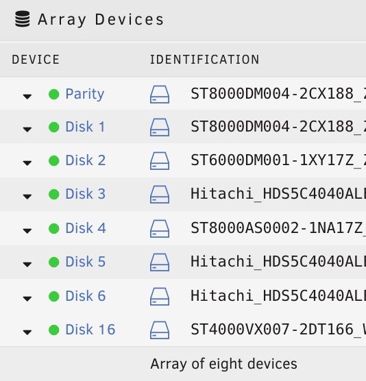

Just to confirm, you're saying you have to reset the config to a new config to re-organize/arrange the disk assignments? I just picked up a new 32GB USB key to migrate my trial to before purchasing my Pro license.
I assume I can use the 'Replace USB key' procedure to also accomplish the 'New Config'? The screenshot shows my current config.... the only disk in the correct slot is Disk 16, which I added there knowing I wanted to re-organize my layout. All disks have data on them, so yes I definitely want to ensure the procedure won't cause data loss.
The new config is purely in reference to disk assignments, it tells unraid that you wish to change slot assignments to different drives.
Trial configurations can't be migrated to new trials intact, as an encouragement to purchase instead of continually changing USB and applying for new trials. Your data is safe, but you will need to redo any docker and VM configurations. I'm unsure just how much you can copy over intact vs. setting up fresh, but I assume you could back up VM and docker XML's and apply them to your existing data no problem. If you purchase a license for the new key, you should be able to copy your backed up trial configuration to the new licensed key no problem.
Purely concerning your drive assignments, with that much change anticipated, you need to evaluate how much time you want to take to keep parity valid through the entire procedure. It would be MUCH faster to simply assign ALL the drives in their final position and build parity based on that, vs. doing the additions one at a time to keep parity valid.
If you wish to keep parity valid, you can put only the current data drives in any slot number you wish, and the current parity1 drive in the parity1 slot. That will allow you to use the "parity is valid" option and simply do a non-correcting parity check to make sure things are working ok.

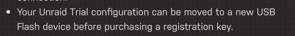

The unRAID purchase page differs from your comment on moving the trial to a new USB key BEFORE purchasing a licence. The attached screenshot is from https://unraid.net/pricing.
