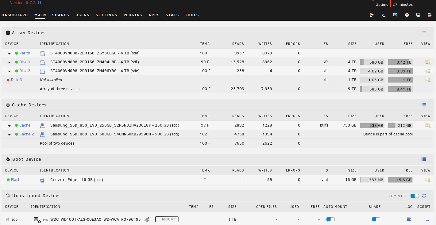

July 20, 20197 yr So there is probably a simple solution to my issue but I don't want to screw something up and lose data. Here's my situation: I have two 4TB drives and one 4TB parity drive in my array. I have an old WD 1TB drive which I added to the array but decided to take take it off the array as I want it to be an mounted device. I did this by stopping the array and unselecting the drive. The array now shows a missing device. I believed some data was written to the 1TB drive while on the array. Do I need to rebuild the array from the parity drive? I'm a bit new in my understanding of Unraid. Thanks

July 21, 20197 yr Community Expert Are you sure there is any data on disk3? Doesn't look like much if any from the screenshot. If it is still like that screenshot, you should be able to access the data from the emulated disk even with no disk assigned to disk3. Click on the folder icon at far right on the line with disk3 to drill down to its contents.
