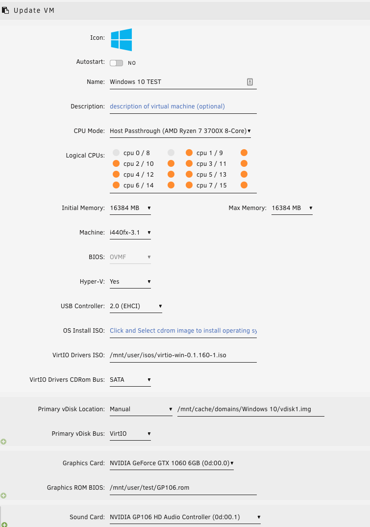

  1. I created win 10 VM with GPU and CPU passthrough according to SPACEINVADERONE video on ryzen 1500x build. I used following settings during unraid boot
    default menu.c32
    menu title Lime Technology, Inc.
    prompt 0
    timeout 50
    label Unraid OS
      menu default
      kernel /bzimage
      append rcu_nocbs=0-15 pcie_acs_override=downstream,multifunction initrd=/bzroot
    label Unraid OS GUI Mode
      kernel /bzimage
      append rcu_nocbs=0-15 pcie_acs_override=downstream,multifunction initrd=/bzroot,/bzroot-gui
    I used following template settings:
However I cant install AMD ryzen drivers for CPU and power plans and CPU is fixed to 3.6 GHz and is not boosting as on normal bare hardware. Any idea how to overcome this?

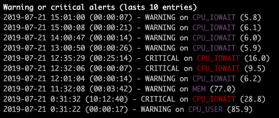

2. I've installed glances and have follwing poping up
