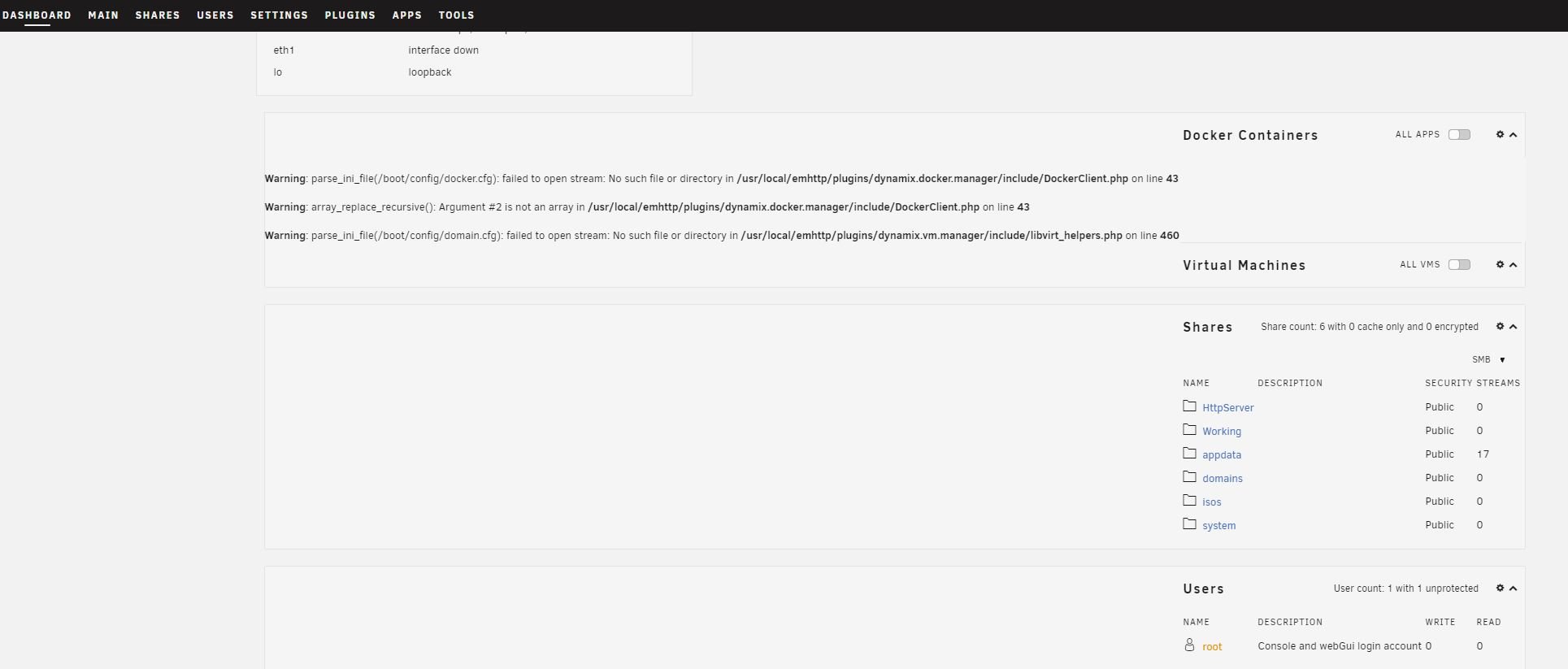

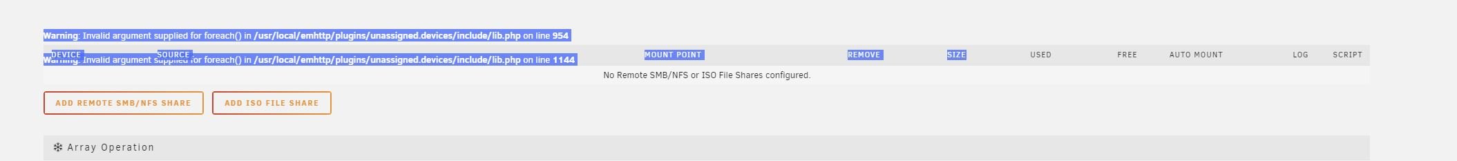

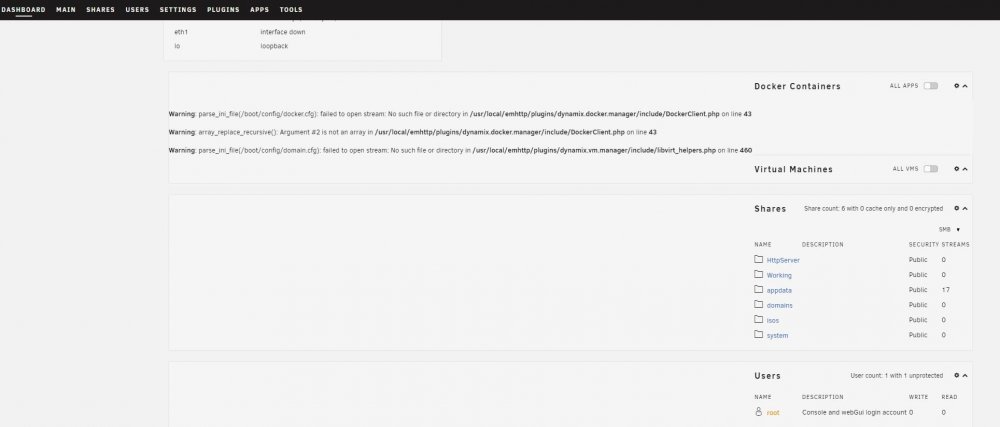

July 21, 20197 yr I've had this issue in worse states but it seems to have returned today as I have left my unRAID install alone and worked within my VMs. I've attached the screenshots of the errors I see and the diagnostics file. When I have these errors I cannot access my Docker or VM controls within the Dashboard. Interestingly, the Dashboard also says my flash drive has been blacklisted. After a restart it seems happy again. I was able to shut down the specific docker containers from within their own respective UIs, and the same for my VMs. So the elements outside the Dashboard are working properly. However, in the past when the log fills to too large things will start crashing in the Docker containers and the unRAID UI will be a mess of php errors. I am running 6.7.0 as the 6.7.1 update basically killed my server (frequent complete crashes) until I rolled it back. Besides being unable to get video out from any GPU (tried recent nVidia and AMD) on any VM (tried Windows 10 and a Ubuntu 18.07?) things are working well. I recently added a few HomeAssistant docker containers though doing that within unRAID has been abandoned in favor of using a Raspberry Pi 3+. So... lots of things going on here. I see the log files are full full full. Anything I need to change here so I don't have to reboot every month? unraid-diagnostics-20190721-1648.zip

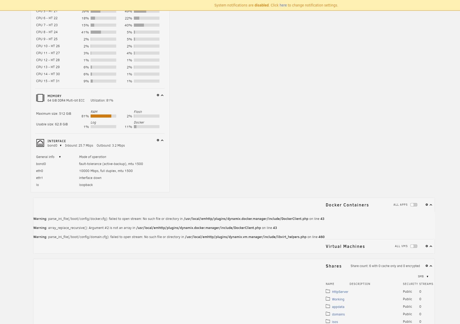

July 21, 20197 yr Author I logged in to unRAID to see if its okay and I have the same errors, same non access to Docker and VMs. System is stable though besides unRAID's Dashboard having a fit. This "notifications disabled" is a reoccurring problem that coincides with other visible errors
