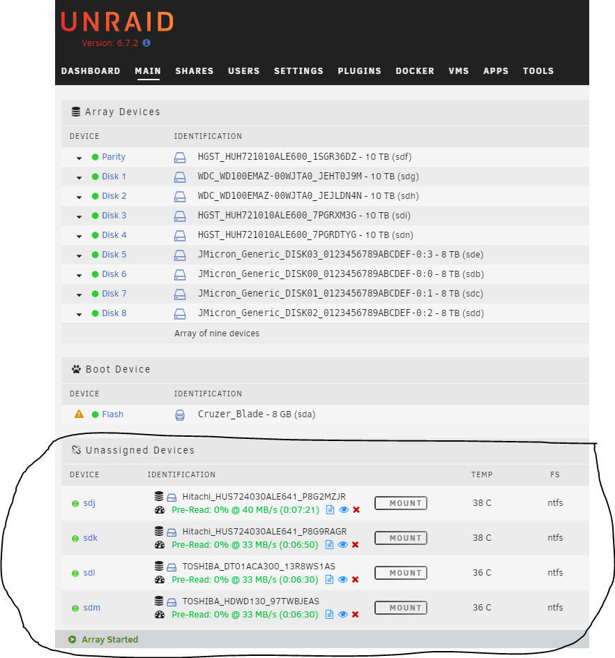

I have an Unraid server with 5 internal SATA drives and 4 additional drives in an external drive enclosure (https://www.amazon.com/gp/product/B00V5ONPAW/ref=ppx_yo_dt_b_search_asin_title?ie=UTF8&th=1) plugged in via USB 3.0.
I am planning on buying a PCIE-to-eSATA card with port multiplier (https://www.amazon.com/gp/product/B07595M2MK/ref=ox_sc_act_title_1?smid=A1C54F8LN6PEOV&psc=1) and moving the enclosure to that card, as well as adding an additional 4-bay external enclosure to it, so that I will have a total of 13 drives (5 internal, +4 in one enclosure, +4 in another enclosure), both utilizing eSATA port multiplier.
Questions:
1. Will the existing drives that are currently recognized as "JMICRON_GENERIC" (see attached screenshot) be recognized when they are moved over from USB to eSATA?
2. If not, what is the best way to accomplish my end goal without "starting from scratch"? If I have to stick with 1 enclosure on USB and the 2nd enclosure on eSATA, I can live with that, but it wouldn't be ideal.
Obviously I would like to accomplish this without losing any data.  This particular server is backed up to another Unraid server, so it wouldn't be a total catastrophe if something bad happened, BUT the amount of data I would have to restore would take days just to copy it back, so I would like to avoid that if at all possible.
No.
A new config might work, it might not, since some USB enclosures don't use the full disk partition, and if that's the case Unraid won't mount those disks outside it.

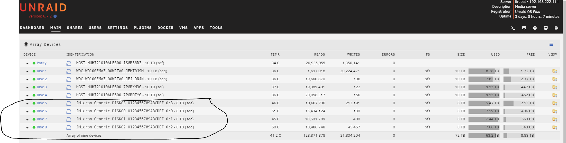

Quick Update:
Well, I received the PCIE-eSATA card today and I put it in the server.  Looks like the existing enclosure (Icy Dock USB/eSATA) that I was planning on using it with is not being recognized.  After mucking around with it for a bit, I just plugged it back in to USB3 and it was back to normal. Fortunately, my other enclosure (ProBox USB/eSATA) is recognized so I was able to add the additional 4 disks (per step #4 above).  For now I am going to stick with this until I can get another ProBox enclosure to replace the Icy Dock. Then I can do the USB to eSATA move.
The disks in the new enclosure are currently pre-clearing.  Once they are done, is it as simple as just stopping the array and adding them to new slots or do I need to use the New Config tool still?
Yes, this  should work.
