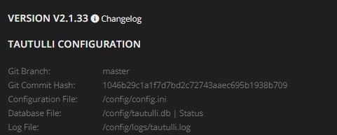

Originally installed 'plexpy' which automatically updated to 'Tautulli'. I am presently running Tautulli with no issue but there must be some residue of plexpy somewhere on my flash drive i am assuming?

OK, It's showing Tautulli though, so not sure why it is referencing that
The docker shows it's plexpy but when I select plexpy it takes me to Tautulli.
Not to sure how to clear this up.

Thank you for the help.
I noted all my plex.py settings + made backups of the database and configs.
installed tautulli
disabled plxy.py (but kept it until i am sure things are operating as they should)
restored db backup and tested.
I think I am good.
