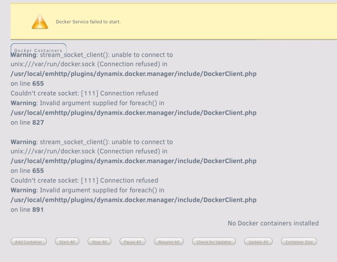

August 8, 20197 yr Hey all, I've had a consistent problem for the past 5+ years with UnRaid taking down the cache drive when a parity check happens (monthly). For this reason I've been running an NUC for Home Automation dockers as this needs to stay up, or at least be back up by the morning. I'd like to put an i7 in and return everything back to UnRaid, but I'll have to solve this issue. I'm currently running 6.7.2 but it's been happening for a long time. I've attached my syslog, it would be great to get this resolved. Thanks Christian syslog.txt
