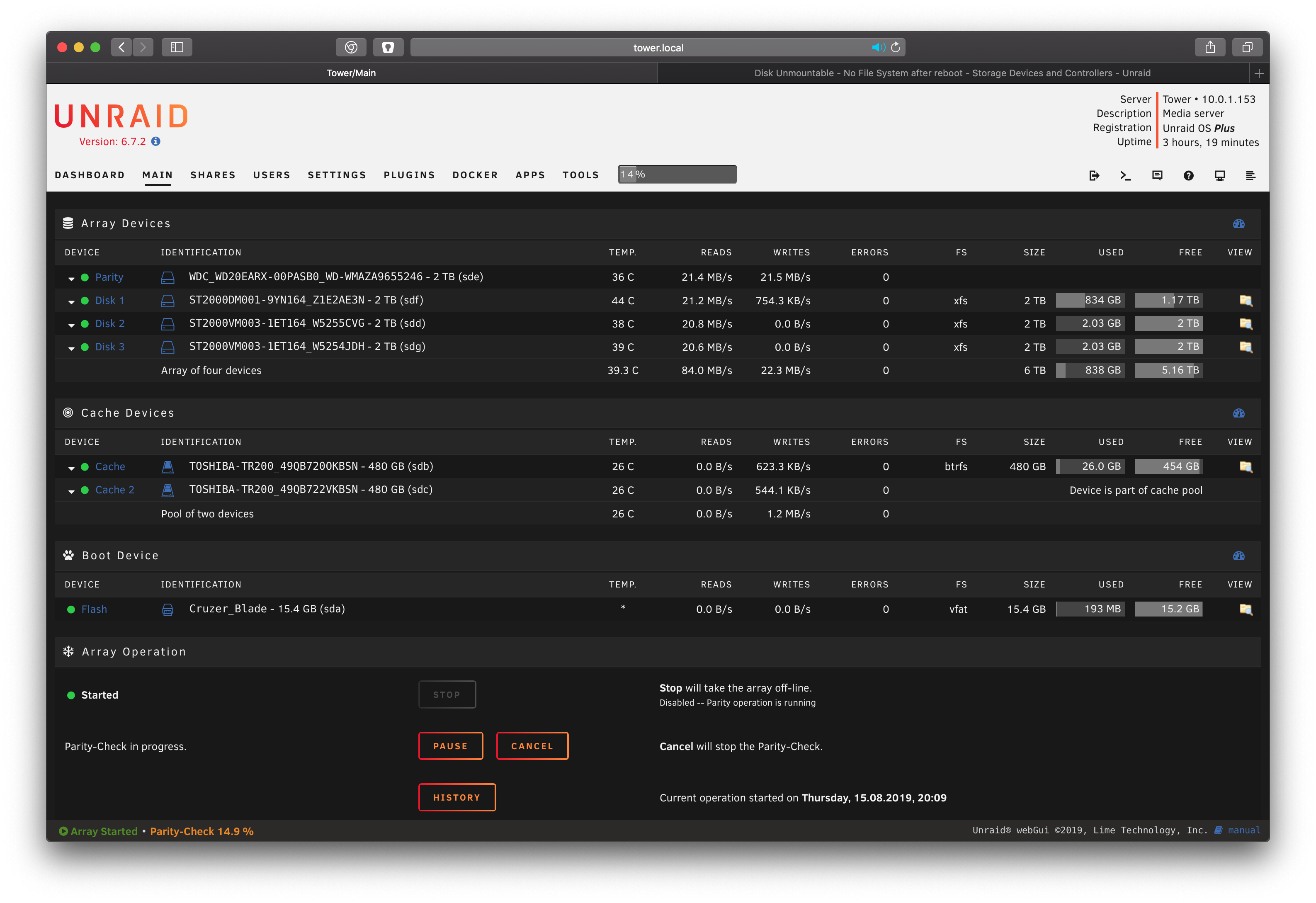

Post a complete screenshot of Main - Array Devices.

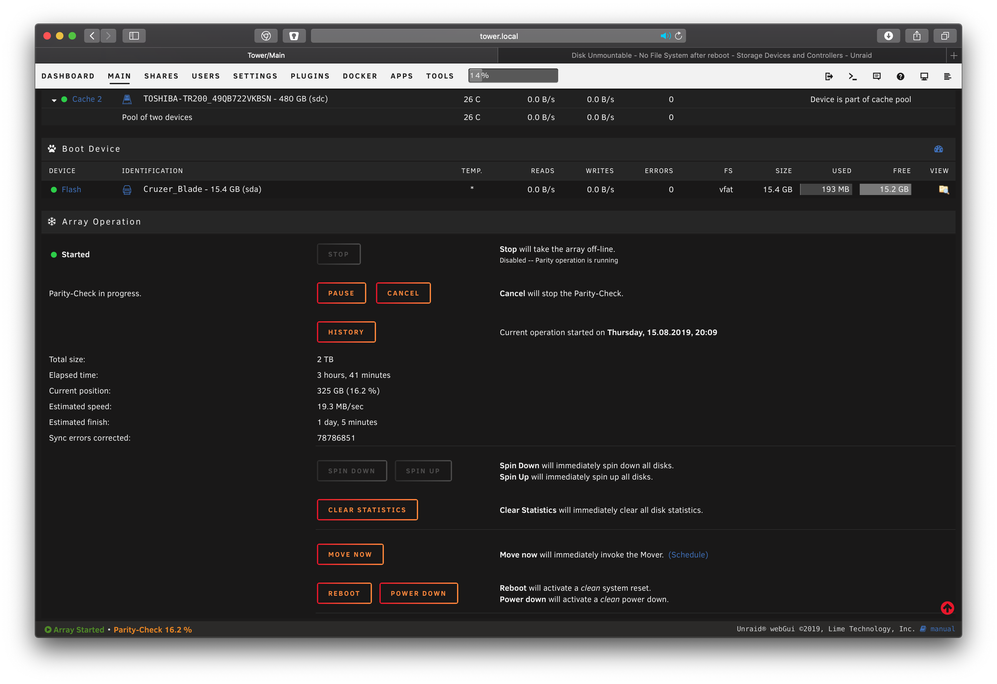

I've attached the screen you've been asking for.

The screenshot agrees that all disks are mounted. Don't know what you had before but it looks normal to me. Do you have any reason to think there was data on disks 2,3?
