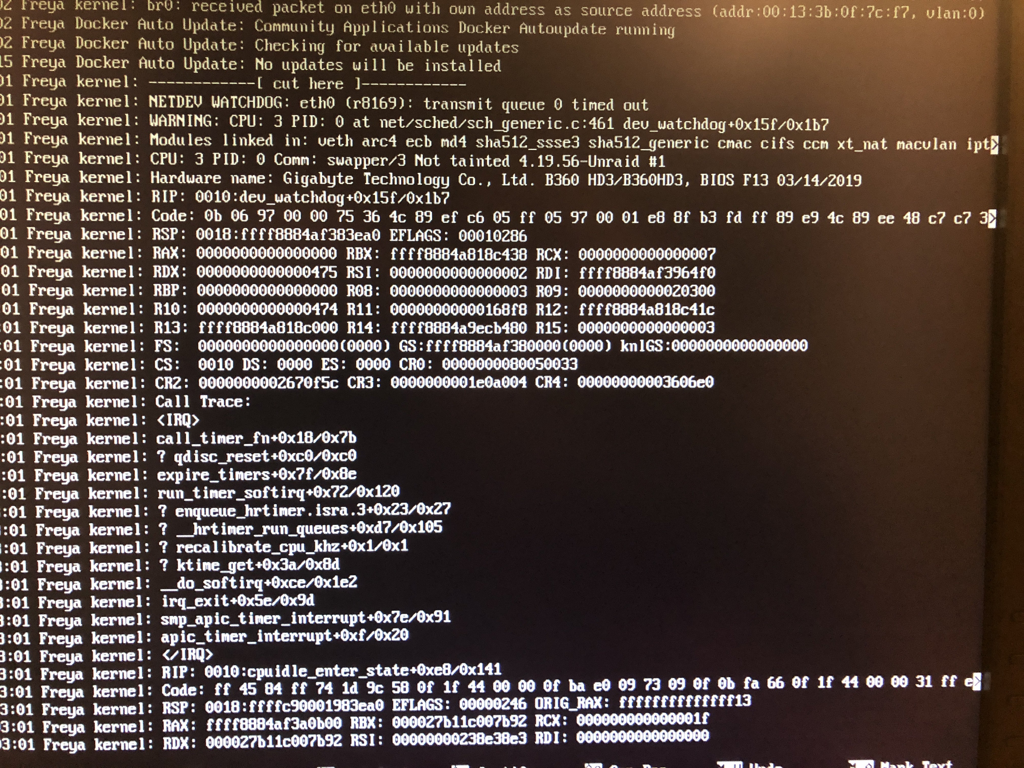

the monitor and KVM attached allowed me to use top and htop to see processes are still running and the parity check i presume is mrecoveryd process is using about 5% of the i3-8100 in the system.  created diagnostics but dont have access to them yet as there is no network connection to the server until i reboot it which i dont want to do until parity isnt running anymore. so I checked the syslog and got this around the time of the "lockup" from about 3 hours ago (took pic sorry not the best lighting
anyone able to trasnlate and diganose this for me? if diagnostics are needed ill post them as soon as i can

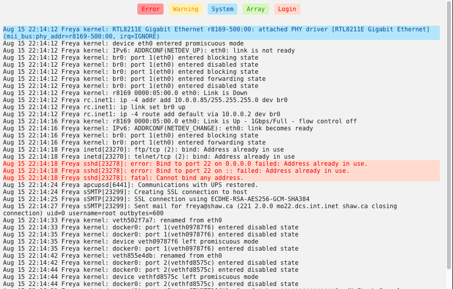

I saw it went down again so i restarted the inet processes again and was able to grab the diagnostics and a screenshot of the log please see attached
freya-diagnostics-20190815-2041.zip
Edited by Can0nfan
update looks like inted is crashing or my NIC driver is
