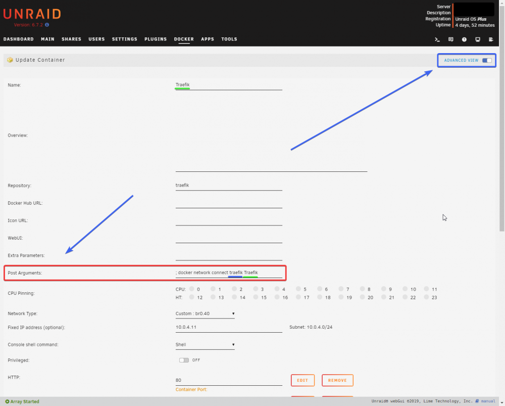

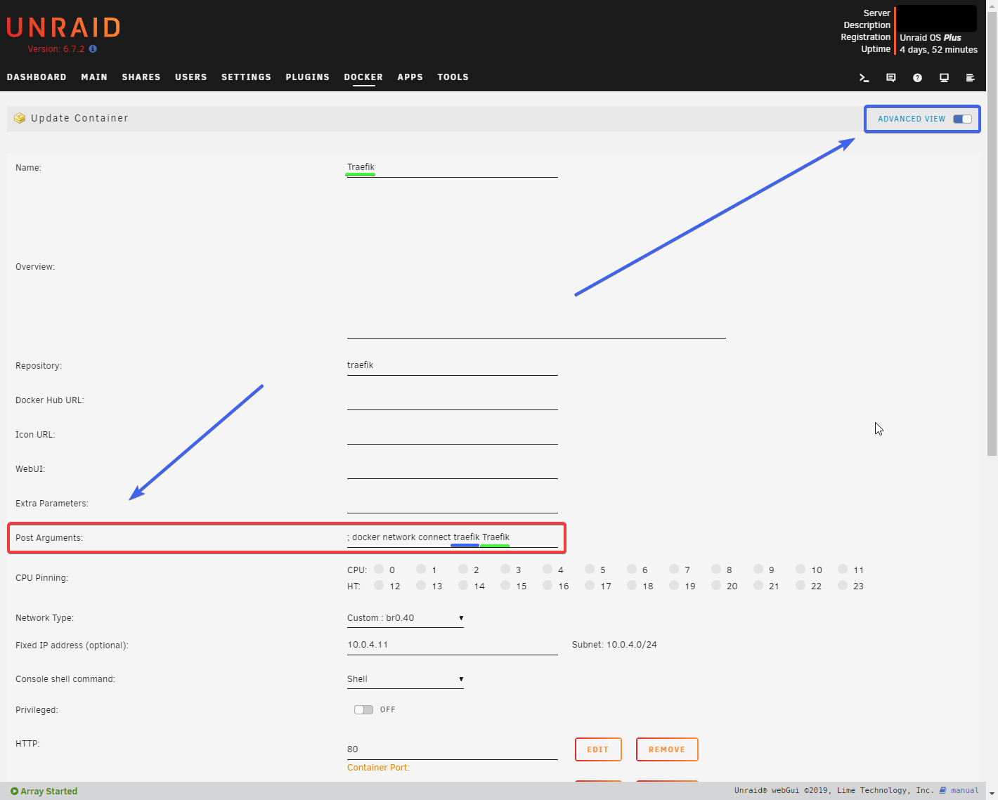

September 1, 20197 yr 14 hours ago, bonienl said: The purpose of the Device field is to add a local device, such as a disk, to the container. You can't add networks this way and need to use the "docker network connect" command as explained before. You can configure the attach network command to be run after it creating the docker. If you go to ADVANCED VIEW when updating/creating a docker container. Under the Post Arguments line you can write the following: ; docker network connect NETWORK CONTAINER Now when UNRAID updates the container, it will run this command afterward to connect it to the right network.
