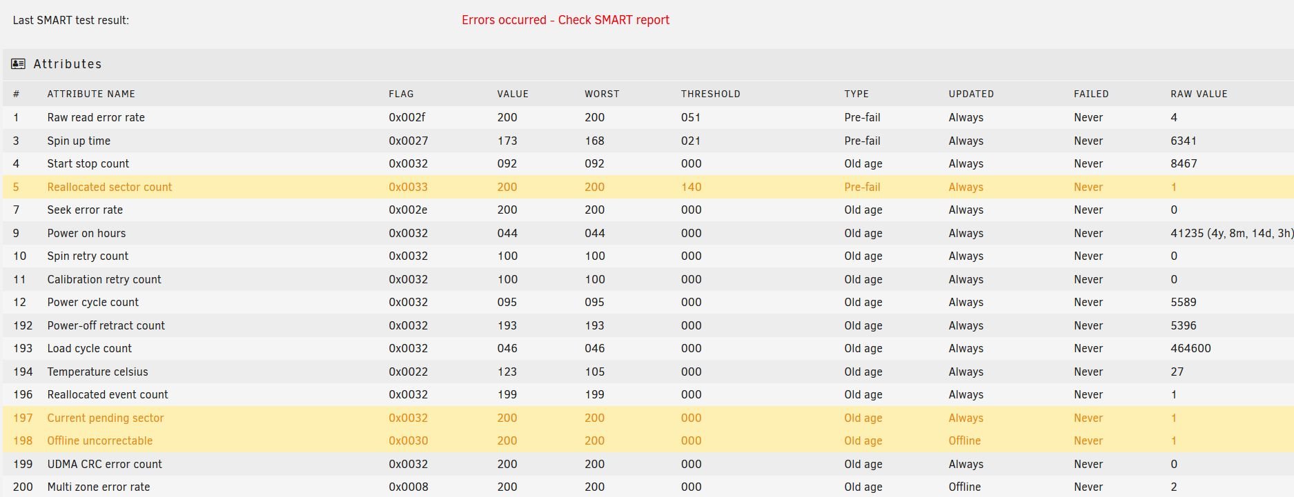

From the attached, I assume I need to replace this disk ASAP?
Event: Unraid Disk 3 SMART health [198]
Subject: Warning [ZACK-UNRAID] - offline uncorrectable is 1
Description: WDC_WD30EZRX-00DC0B0_WD-WMC1T1747891 (sdd)
Importance: warning
WDC_WD30EZRX-00DC0B0_WD-WMC1T1747891-20190907-1046.txt
It appears so, you can run an extended SMART test to confirm.
@johnnie.black - Thanks! I thought I did attach the extended smart test? IS there another test I can attach? Or was that the "regular" test? Thanks!
Yes you did, sorry, missed it, SMART test failed confirming you need a new disk.
@johnnie.black - many thanks! I really appreciate your help!!
