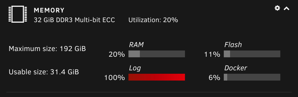

September 11, 20197 yr I recently developed a log problem on one my unRAID servers, as you can see from the attached image. I figure rebooting the server might fix it, but is there a command I can run to stop the log daemon and restart it, effectively fixing this?
September 11, 20197 yr 38 minutes ago, ashman70 said: I figure rebooting the server might fix it It will To restart and cleanup /etc/rc.d/rc.rsyslogd stop rm /var/log/syslog* /etc/rc.d/rc.rsyslogd start Edited September 11, 20197 yr by Squid
September 11, 20197 yr Do you know what the problem is/was? If not, probably best to post diagnostics before you do the above
September 11, 20197 yr Author I believe it was when I was moving everything off my cache drive, it seems for some reason, that triggered an old docker I had for a security cam and it kept trying to establish an FTP connection to my server, thus, filling up the logs.
