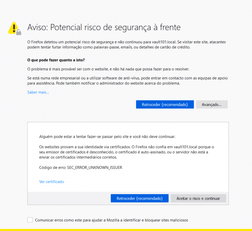

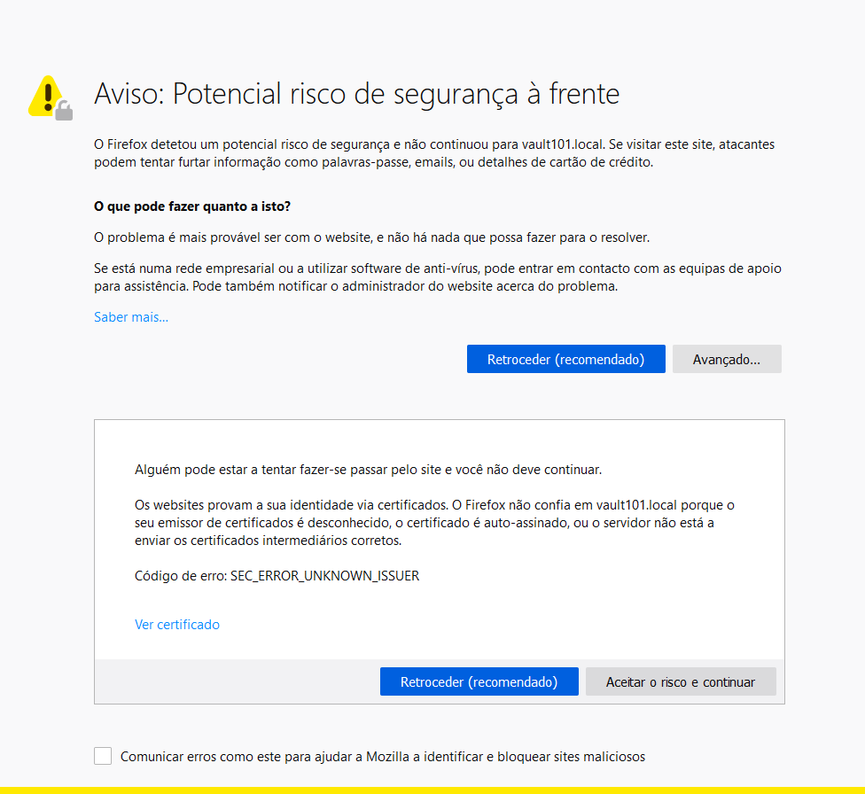

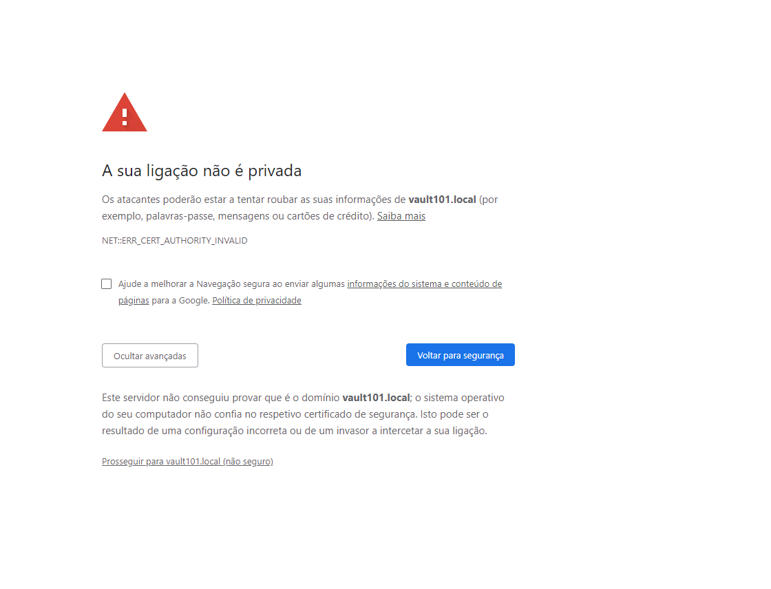

I can enter the shared folders on unraid via network, but when I try to enter via browser I get several unsafe certificate messages:
firefox: SEC_ERROR_UNKNOWN_ISSUER
chrome: NET::ERR_CERT_AUTHORITY_INVALID
and there's no option to add any kind of exception and if i press continue it loops. This is a fresh machine, i´ve tried even with anti virus disabled.

I did a google on  unraid.net  " firefox: SEC_ERROR_UNKNOWN_ISSUER"  and got only two hits.  You might want to do the same and see if anything in the 'solutions' might help with your problem.  (I have never heard of this issue with Unraid before.)
If these did not fix the problem, please get a screen capture of the entire Error message and post it up with your next post.

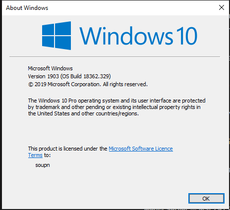

 Get a screen capture of the output of the command    winver    (With Win10, you type this in the search box on the bottom toolbar of the desktop.)
Firefox: https://www.dropbox.com/s/bepjq35g0r4qgp2/firefox.png?dl=0
Chrome: https://www.dropbox.com/s/1bnul0njz6yxh2e/chrome.png?dl=0
When I press the Ignore and continue, it does nothing...
https://www.dropbox.com/s/7jlf4sr4zsi6bvx/winver.png?dl=0

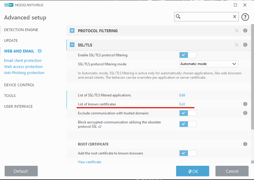

Hello, after some time I had to check my anti virus software options and the problem was there.
I use ESET Nod32 AV, and there's an option enabled by default SSL/TLS filtering, and I had to add my local cert to the List of Know Certs.
Everything working fine now.
thanks.
