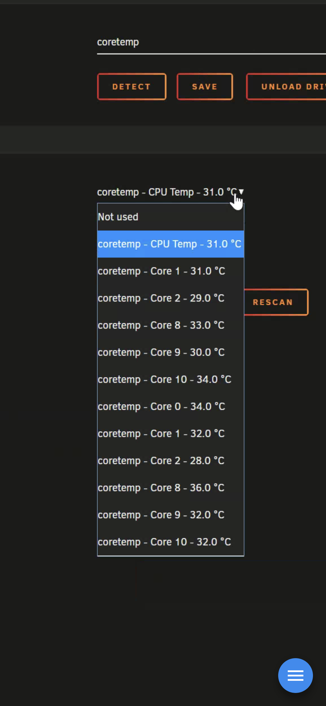

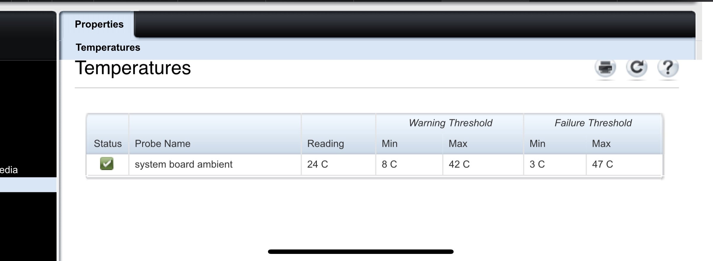

Can someone give me a hand on getting my system temps to read correctly? My unraid temps are showing 35-40c while my dell r710 diagnose screen is showing around 23c, not a huge deal but it’s not very convenient. I have setup dynamix system temps with Perl and that is the false readings I am receiving.
Typically there will be several sensors listed, and it often isn't clear which is the right one. If you can't figure out which sensor to choose, post screenshots showing the sensors dropdowns in System Temp settings.
It list the same under the MB and list nothing for the fans also posted what the temps should be reading according to idrac “witch is correct according to my temp gauge”
Edited by Lassley7
Looks like you haven't detected the other sensors. Sometimes they aren't detected by the perl script. Depends on how new the hardware is.
