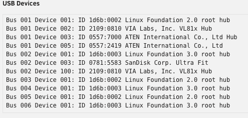

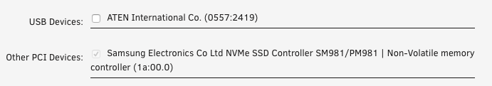

September 25, 20197 yr Author Hi, New MacOS kvm is up and running, Nvidia GPU and nvme ssd are passthrough, and works fine. I would like to passthrough usb and boot from the nvme ssd as well. In the xml form view a USB Aten International is selectable, but I can not connect to the kvm (it starts) when enabled. Disabling it, and I can again connect to the kvm. It is no pci usb in the server, only the onboard ones. System Devices show different usb devices, how can I pass some of them through? The other topic is how to boot from the nvme ssd. A MacOS spesific setup of SIO`s Windows solution would be nice. Appreciate any help. Edited September 25, 20197 yr by frodr
