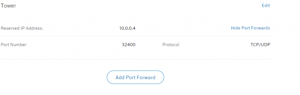

Tried changing it around nothing worked i went from 32400 to 34444 and 40444. I think i set it up right on router side.

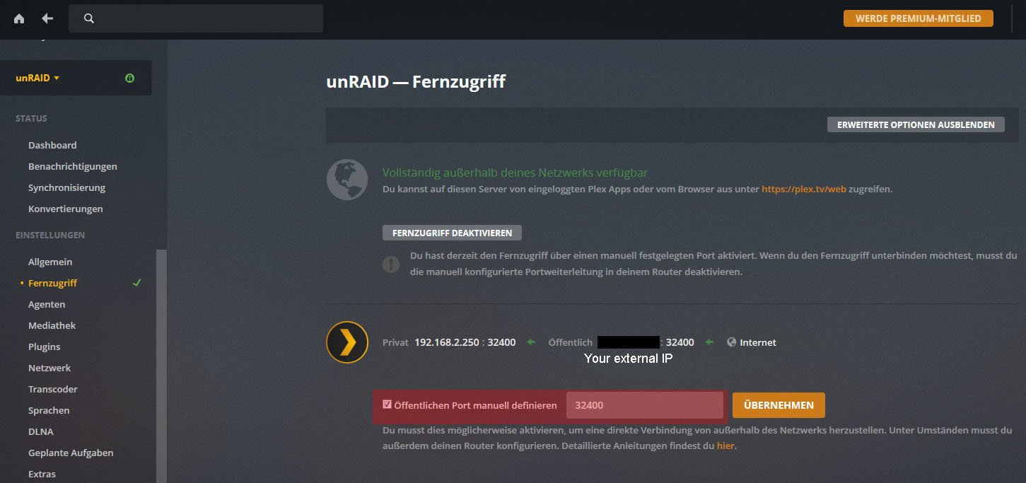

Did you enter the port also in the Plex interface? This does not work without this (red marked) entry.
(The word "Fernzugriff" means remote access)

Cant "manual" set it Comcast forces you to use their xfi app to set port forwards it doesn't let you type in the ip that you want forwarded it scans all connected devices it show up a list and then you click on device in the list.
