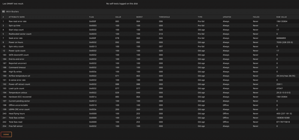

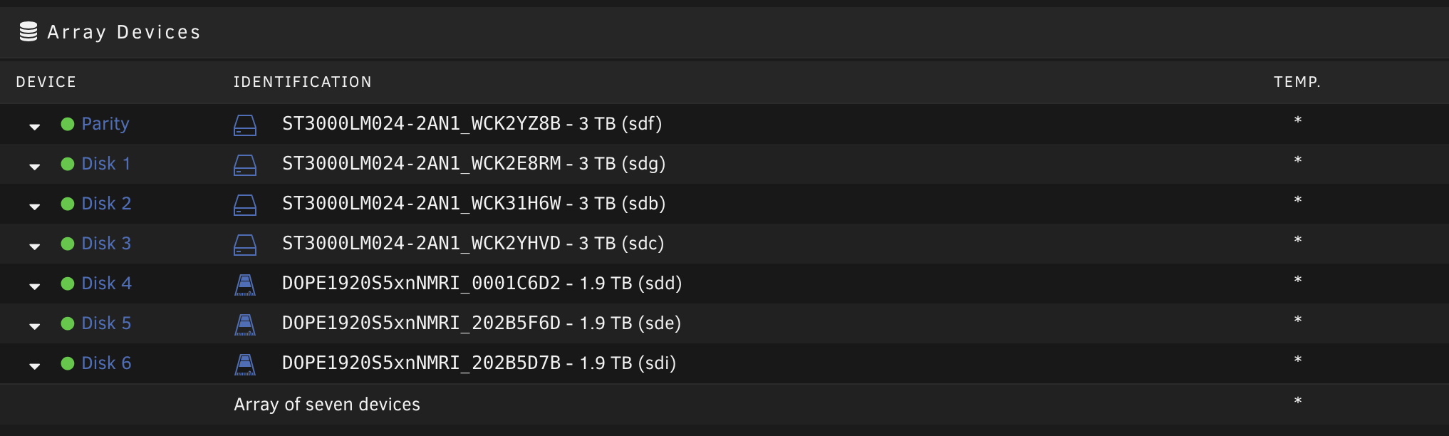

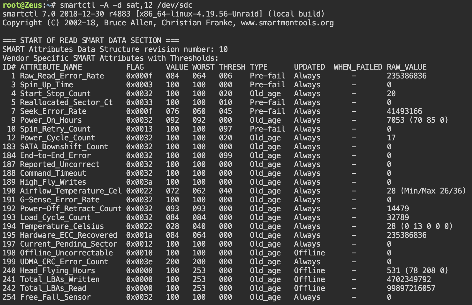

October 3, 20197 yr I have the problem that with none of the hard disks the temperature is indicated. All hard drives are active. The temperature can be read out with SMART Tools. Only the temperature of a unassigned device is displayed.
October 5, 20197 yr Author Where can I start? My Unraid Version is 6.7.2. The HDD Controller is an P420i in HBA Mode. zeus-diagnostics-20191005-0857.zip Edited October 5, 20197 yr by Sascha_B
October 5, 20197 yr Community Expert Easiest way would be to use a recommended LSI controller, but it might be possible to get temps with that one using custom SMART settings, maybe someone else with same controller can help since I never had any of those.

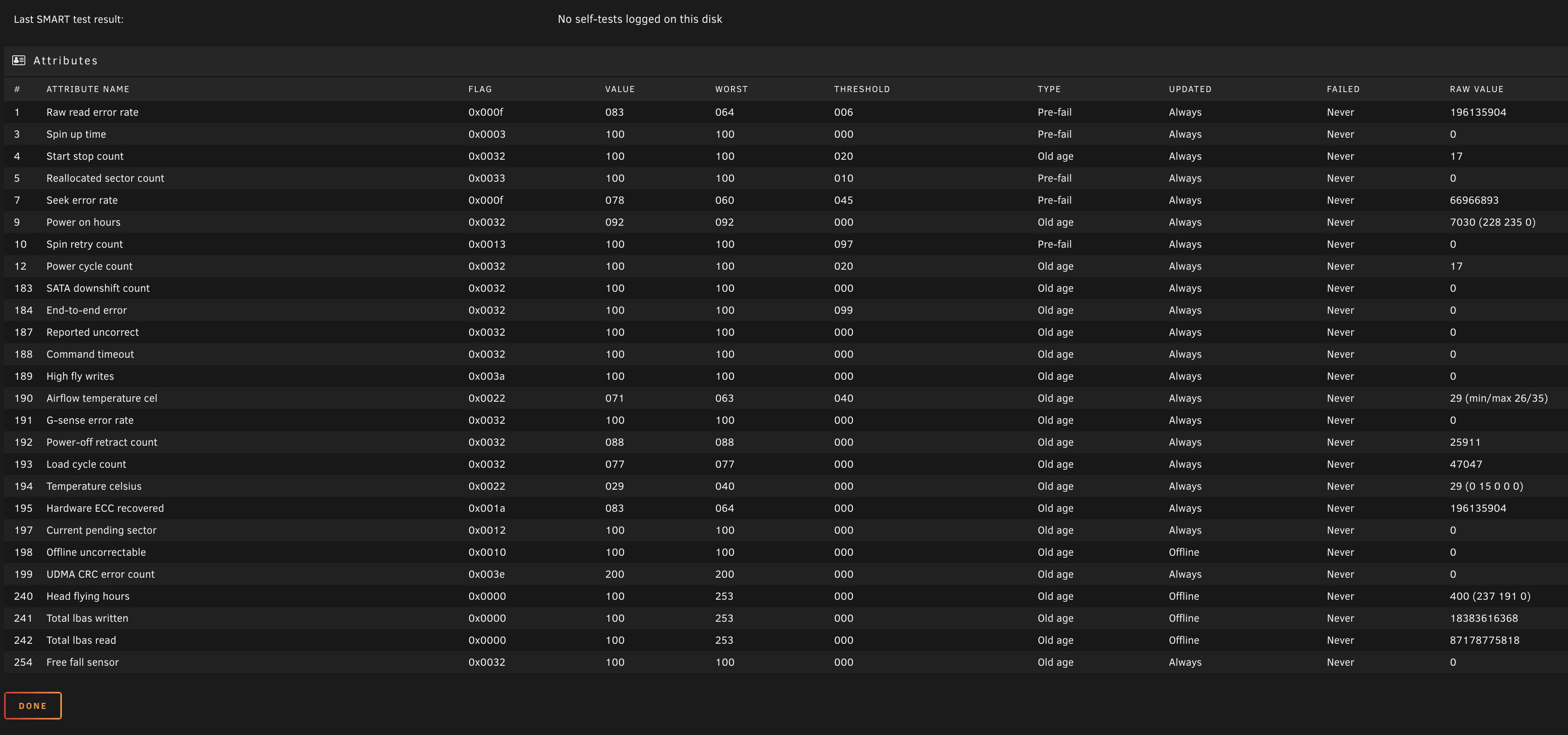

October 6, 20197 yr Author Are the values not read out via SMART? There are values displayed everywhere, but not in the dashboard. Is it possible to connect the LSI controller to the backplane of the HP?

March 13, 20224 yr Did you ever get this figured out. I have the same problem. It’s interesting because all my disks that are unassigned show a temp but once I add them to the array it disappears.
