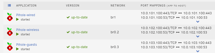

If you want to keep network segregation, the best way is to set up a dedicated pi-hole server for each VLAN (network).
Below an example of my setup
But wouldn't I have the same problem because of my VLAN firewall rules? Being my client devices on the guest/family network would not be able to connect to the secure network (unRAID box/Pi-Hole) in order to access the Pi-Hole DNS server? Since the Pi-Hole server is on the Secure LAN?

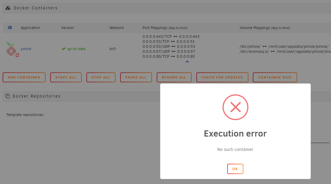

Well I went to restart unRAID and I got this:
update: I'm not sure why but the network setting for pihole and unraid were all scrambled. I deleted and reinstalled pihole. It's working now but not across VLANS still. I'm considering scrapping all my EdgrouterX's firewall rules and starting over.
Ok update on this I finally got it working. I created a rule in the GUEST_TO_LAN ruleset to allow destination traffic to the pihole's IP address on port 53. But it was important to move this rule to the top of the ruleset to get it working properly. See my post here for more info.
@bonienl, out of curiosity what router are you using?  And another thing I found out today. Every time I rebooted my unRAID server the Pi-Hole docker would fail to open again. It was happening because the unRAID server was getting a new DNS of the Pi-Hole itself. So in unRAID's network settings I had to set the DNS to Static and list my Edgerouter IP as the DNS. Does this make sense? Is there another way?
