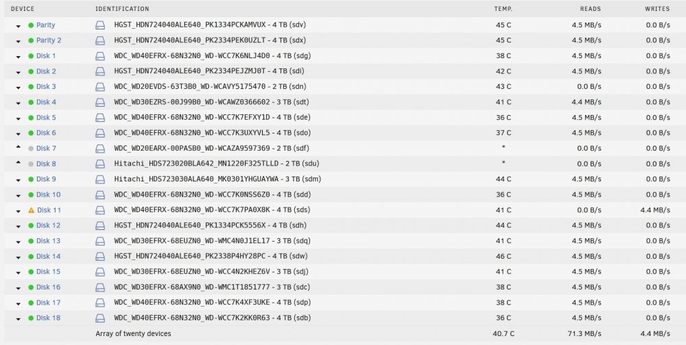

Thanks, Johnnie. The speed view shows all drives reading and writing at about the same speed. Does this tell us something?
capture_20191015-153031.thumb.jpg.9cbf69aca5a019a254871f4e1b99b077.jpg.
That is not going to help much as the rebuild cannot happen faster than the slowest disk.
Using something like the DiskSpeed docker container would be one way to check out the performance of individual drives.
