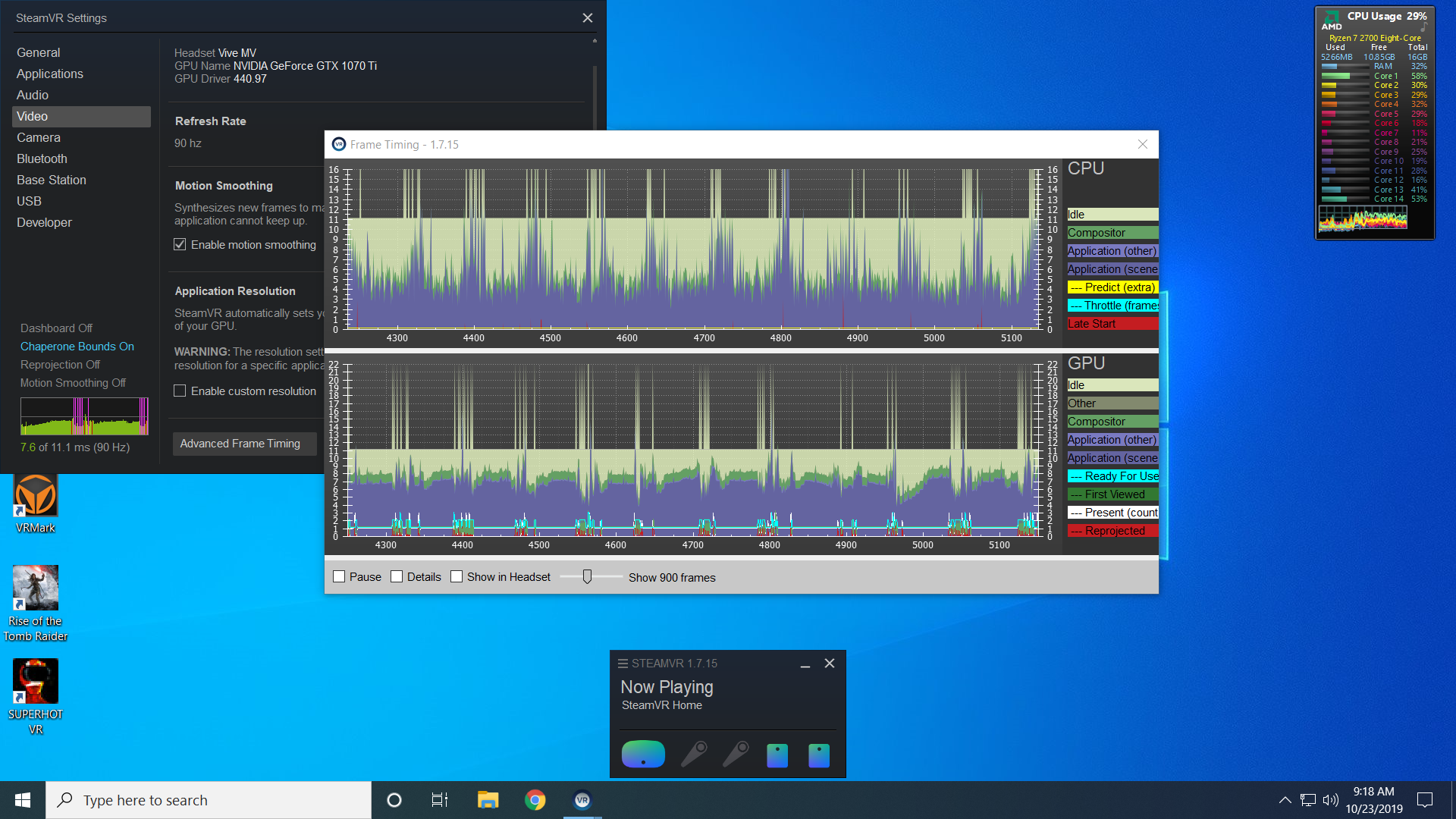

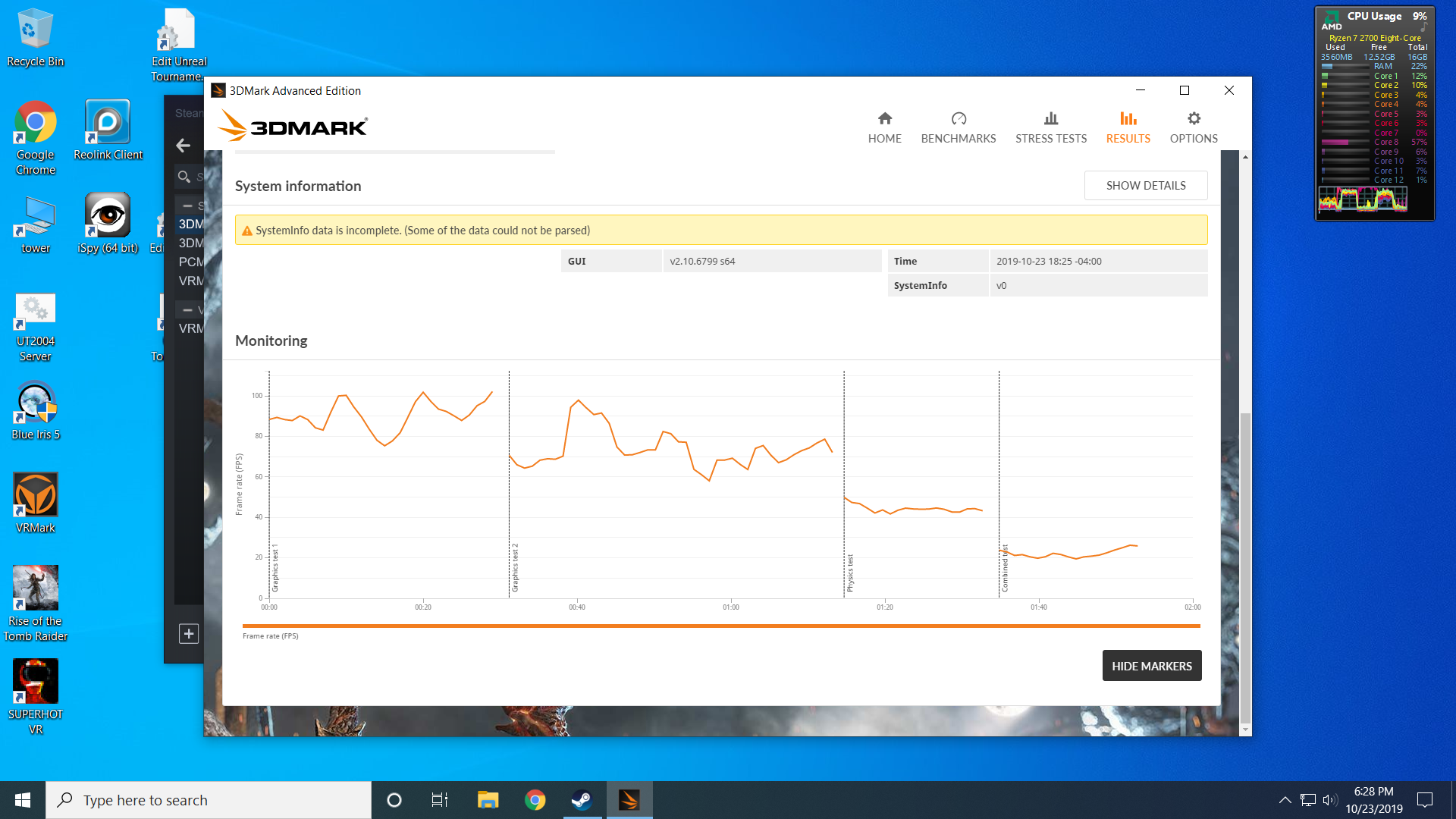

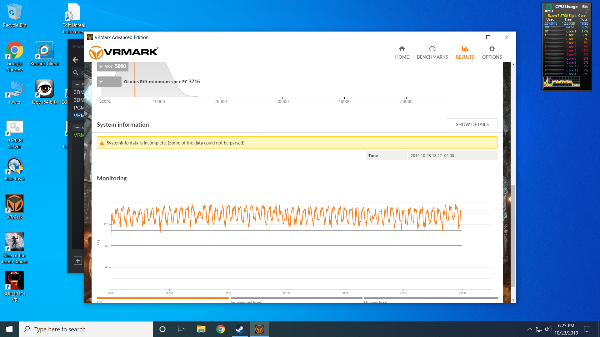

I'll attach a few screenshots of PC Mark vs. VR Mark to show the difference in frame rate fluctuation.  The tests were run consecutively with no settings changes or rebooting.
Firestrike.thumb.png.d9d7e434bf561d38df4128d5f1abc0ba.pngVRMark.thumb.png.66a6dc294e06d9eaebf0115555f8d5dc.png
At this point I really don't want to mess with Unraid updates and risk screwing something else up.  I'll just put the 1070ti back in my VR rig for now instead of selling it.  If anyone has any ideas as to why some firestrike would run fine (although not ALL the time) and VR mark would have issues I can always try again.  But for now this is exactly what I expected, some weird issue that I could chase indefinitely and probably never really find a solution.  But at least I got GPU passthrough working so I can make changes to my surveillance VM locally, You win some and lose some
