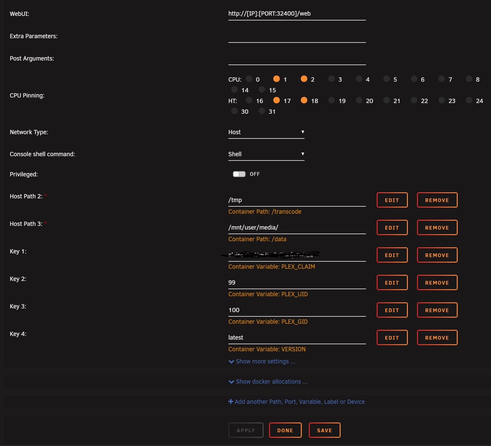

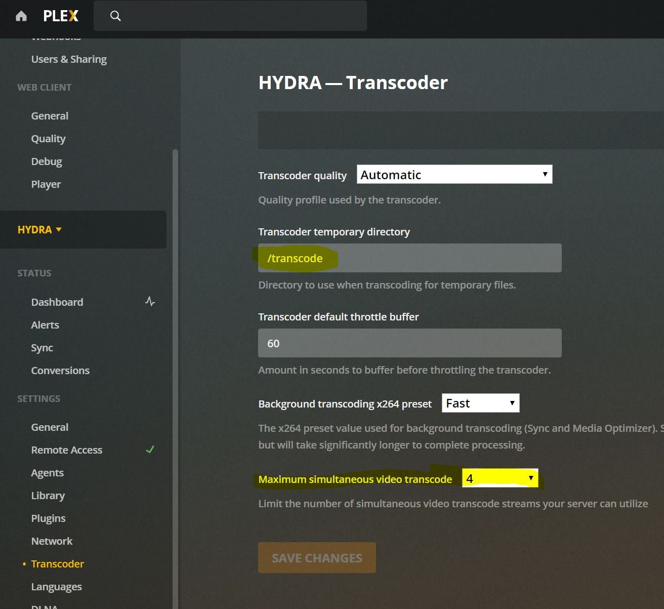

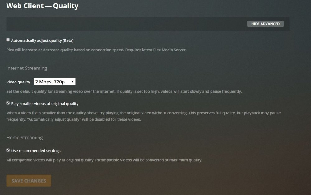

This is roughly my setup I'm using.  Plex Docker (Plex's official container from CA Apps), allocated four CPU threads - basically 1-4 streams in theory (Threadripper / no gpu), Streaming to a Raspberry Pi3 - RasPlex, pushing out 1080p on local network; however pushing over the internet my Plex clients get 720p - set on purpose due to limited upstream bandwidth.  Media is MKV, some mp4, mostly H.264 encoding some H.265, file sizes 2 - 14GB;  I've found the RP3 tends to choke on my H.265 media as it gets directplayed and not transcoded (RPi3 doesn't have the hardware to do H.265 decoding native).
A friend of mine has Roku with Plex, which he streams from my library all the time.
Edit:  added some pictures of my config, in case it helps.  First picture you can see I've allocated some free CPU threads to container; I've also pointed the container's /transcode folder to Unraid's ram-drive /tmp - although with 16GB of ram for your system you might want to test that.  Next two are from inside Plex Server configs; transcoder directory matching container config and setting max simultaneous video transcode to number of CPU threads I allocated to container.
