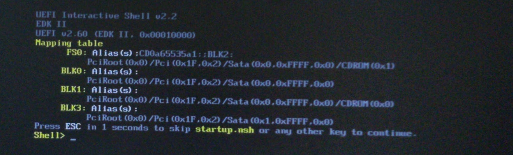

I have a Unraid set up with several VMs all running Windows 10. They were all freshly installed a few weeks ago on a brand new PC. I had to increase the allocation for the HDD on one VM and when I restarted the system all of the VMs will not load into windows and will only boot into the shell screen (see attached). I cannot get them to boot back into Windows 10 and into each VM.
I only get the option to boot into Windows set up and not the actual VM. I tried to remove the Windows install path and that didn't work. I tried to change the location for VM's from cache to user and that didn't work. I tried to change the Machine from Q35 to i440fx and that didn't work.

1. fs0:
2. cd efi
3. cd boot
4. bootx64.efi
This just restarts the VM and comes back to the same Shell screen.
The following thread says Seabios rather than OVMF for the BIOS helps resolve the issue but I'm trying not to recreate each VM if I don't have to.
[https://forums.unraid.net/topic/55887-unable-to-create-vm-just-boots-to-uefi-shell/](https://forums.unraid.net/topic/55887-unable-to-create-vm-just-boots-to-uefi-shell/)
I typed in exit and it takes me to the BIOS boot menu but none of the options boot into the installed Windows vm. I see boot options for floppy disk, two different network boot options, and misc EFI shell which all don't boot into the existing VM.
