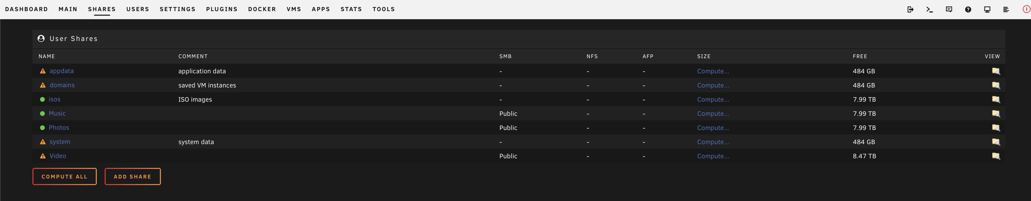

Also, setting up shares, I used identical settings for these shares and there is an exclamation mark on one of them warning me that some or all files are unprotected.  I went back in and told it to use the settings for the other share (music in this case) that was working OK, but it still says unprotected.  All the shared folders are empty at the moment.
Was going to try and delete it and start again, but there's no checkbox to delete it and it says it contains data, I hadn't put anything in there, but I did open the folder on a Mac and it looks like some Mac database files are in there.  Found a post with a way to delete from the command line, but both Krusader and the terminal from the top right of the main screen just give me a blank grey screen when opening.  Not having much luck today.
Edit: Managed to do this from command line on the server itself rather than from the web browser.  I would still like to know how to get the terminal or crusader's command line on the web browser though, please.
