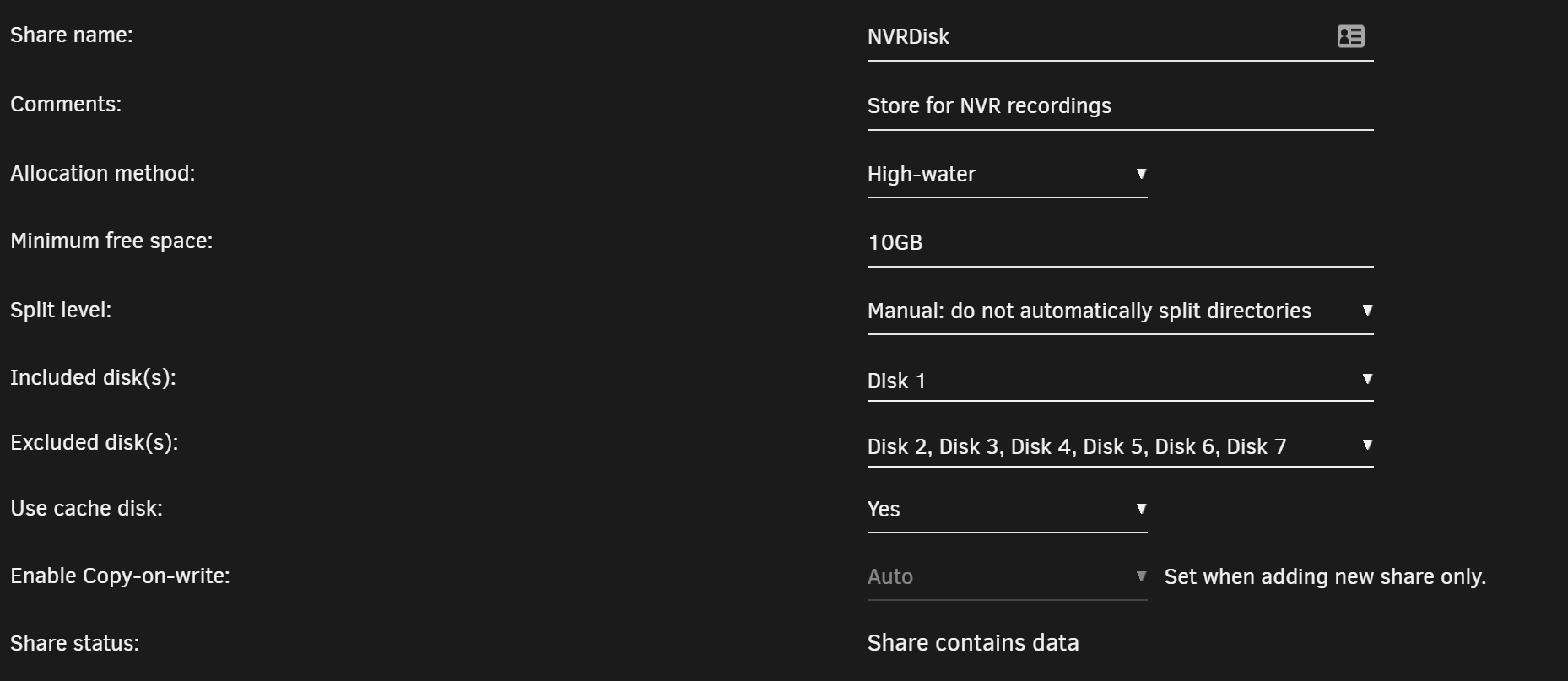

Hmm.... I seem to have pinpointed when all disks spin up. As to the why, I have no clue.
I have a share that is limited to one disk (disk 1). It has prefer cache set so everything written to the share is written to cache first.
If I read access that share, I would expect that only that one disk would spin up.
- What happens is that disk1 spins up. As I expect.
If I do a write/delete/modify on that share, I would expect disk1 and parity drives to spin up.
- What happens is that disk1 and the two parity drives spin up. And after a short period, the rest of the disks also spin up.
In addition to having only disk1 included for the share, I have tried to also specifically exclude the rest of the disks. Didn't change anything.
Can anyone explain this behaviour? Am I missing some setting or am I misunderstanding how this is supposed to work?

Uhm, "prefer" cache means anything written to /mnt/disk1/share will be moved to /mnt/cache/share whenever mover runs as long as there is space on cache.
Edited by BRiT
Yeah, sorry - I was wrong. I meant that it's set to use cache. The setting I have is "Yes"
