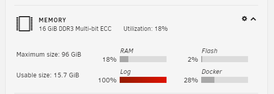

I notice the log keeps repeating "e":"can not get logs from container which is dead or marked for removal"}".
I think the system log file is getting full of this repeating. (check picture)

Ok, I just notice my Log file says its at 100% now. Where can I find/fix this?
I think this has to do with the tautulli docker as it is not working and giving me a bunch of errors. I'll check it tomorrow I guess...
