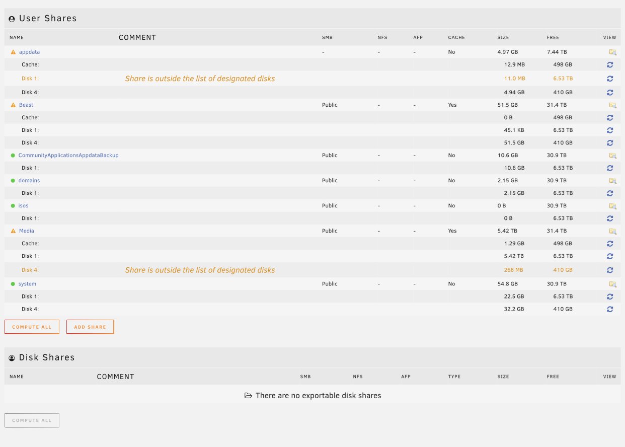

Go to Shares - User Shares, click Compute All, wait for the results, then post a screenshot.

Your screenshot is about what I expected, but I just wanted to make sure because your flash drive has a lot of files in config/shares (where the user shares configurations are stored) that don't appear to be used and their (anonymized) names seem very peculiar. Possibly you accidentally created a lot of user shares at some point by copying a lot of things to the top level of a disk.
