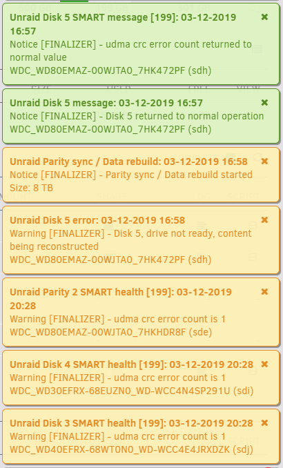

Well maybe this answers something.  I was doing a rebuild on Disk 5 (new disk but same slot) and I got more errors on the parity and Disk 4 and Disk 3.  This makes me think it has something more to do with a cable, backplane, or HBA.  I have 2 power supplies so I hope it is not the but I guess it is possible.  I am going to let it rebuild Disk 5 then probably shut it down until I can get new cables unless there is no risk of corrupting the data?  Before I tried rebuilding the drive I tried to check all the connections to make sure they were tightly connected.
UDMA CRC errors are usually a bad cable, much less likely but can also be controller or backplane.
Not with UDMA CRC errors, but if more disks have read errors it can, just post the diags after the rebuild is done if you're not sure.

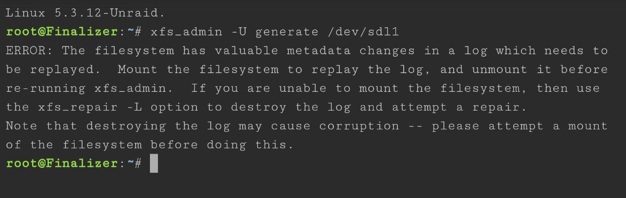

I typed this in and this is the warning that came up. Should I delete the log?
See if the disk mounts before clearing the log, you can do that after stopping the array and then try to mount with UD, if it still doesn't mount the duplicate UUID isn't the problem (or the only problem), so run xfs_repair first.
