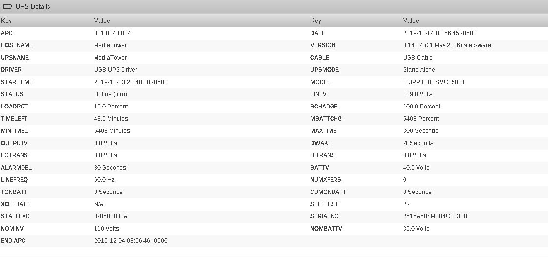

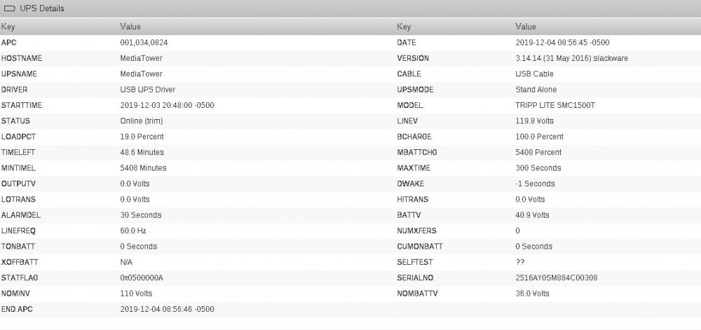

I did a plugs-out test against my UPS last night.
I think I have something wrong with my UPS Settings.
I have my Tripp-Lite 1500 setup(In Unraid) to stay on UPS Power for 5 Minutes.
As soon as I went on UPS power unraid initiated a shutdown and was powered down within 45 seconds.
My server is the only thing plugged into the UPS. I wish it was an APC but seems to be recognized by UnRaid.
It's a Dell Server with redundant power supplies.  It appears to be consuming ~ 250 watts under normal conditions.
Is this a config issue or a problem with my UPS?

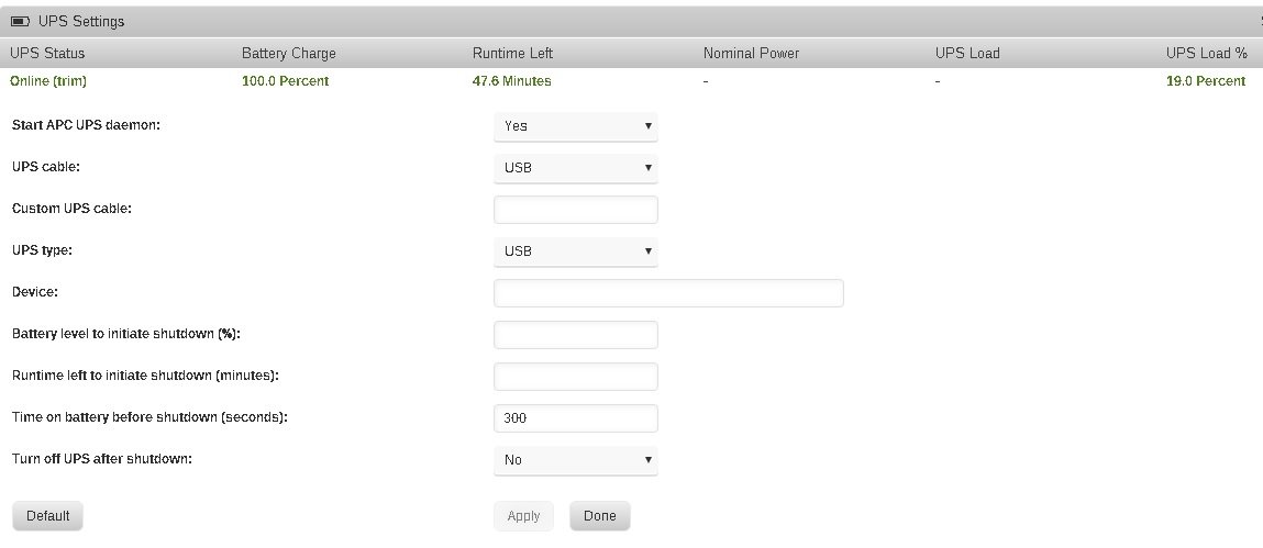

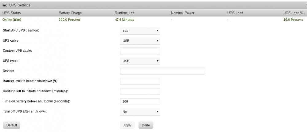

You appear to have nothing entered in the fields "Battery level to initiate shutdown" and "Runtime left to initiate shutdown".  From the details dispay it seems that these fields have therefore got some random data in them.  In particular the charge left to initiate shutdown seems to be at over 5400%, and therefore even a full battery (yours is at 100%) may not be enough to prevent an instant shutdown.  Try setting the first parameter to 50% and the second to maybe 5 or 10 minutes.

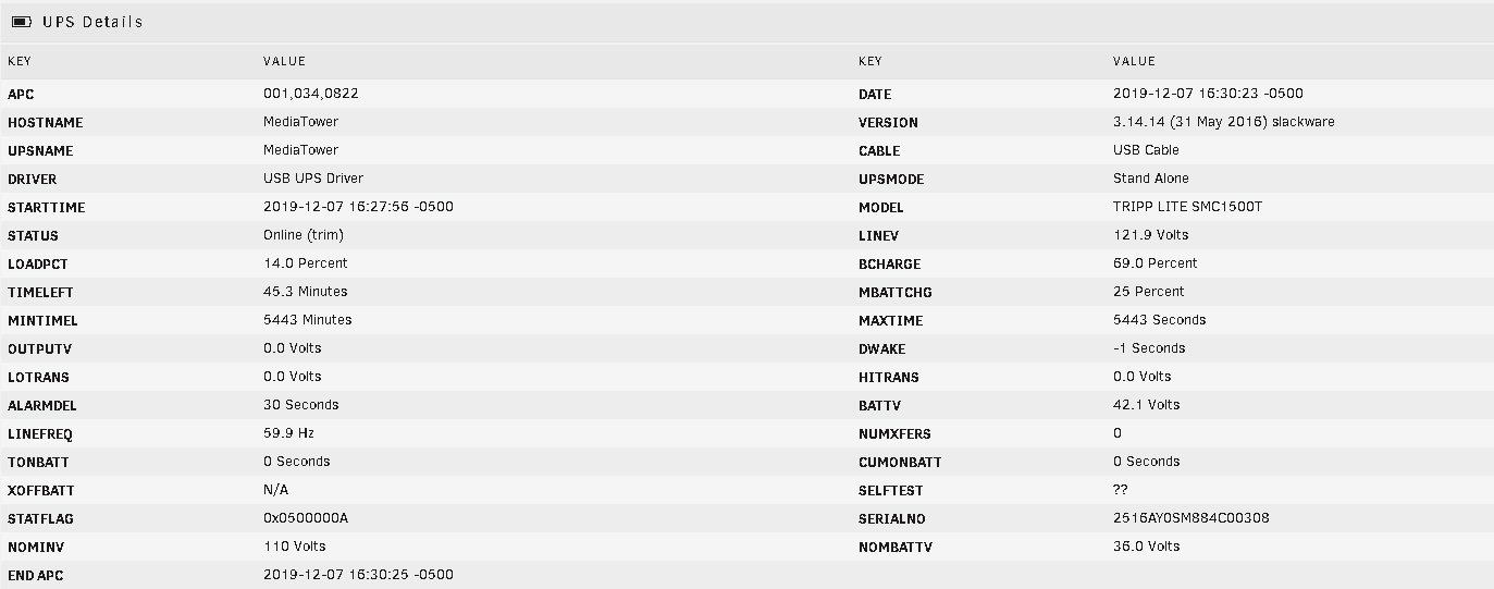

I cleared Time on Battery and entered values for %Battery Remaining for Shutdown. Now the attribute "MBATTCHG" shows 25 %.
I do like the idea of testing on a similar load. I measured 260 watts with all drives spinning and the server running under normal load.
I will find a similar load and test with that.
I added parameters in UPS Settings for % Runtime remaing 25%.
I took the array offline and shut off the power at the breaker.
Checkng the status of UPS Settings from my laptop showed that the server went straight to shutdown.
I am trying to figure out whether my batteries are not holding a charge or I have some other issue.
The attached log shows that the charge dropped to 68% but the server only ran on battery power for 60-90 seconds.

300W load on that model shows 28 minutes of predicted runtime, so, yeah, either your batteries are bad or your load calc is wrong.
BTW, 90 minutes before time triggered shutdown is way too long. I'd leave that at 300 seconds. SLA batteries don't like deep discharge, I'd shoot to keep the batteries above 50% charge state at all times.
