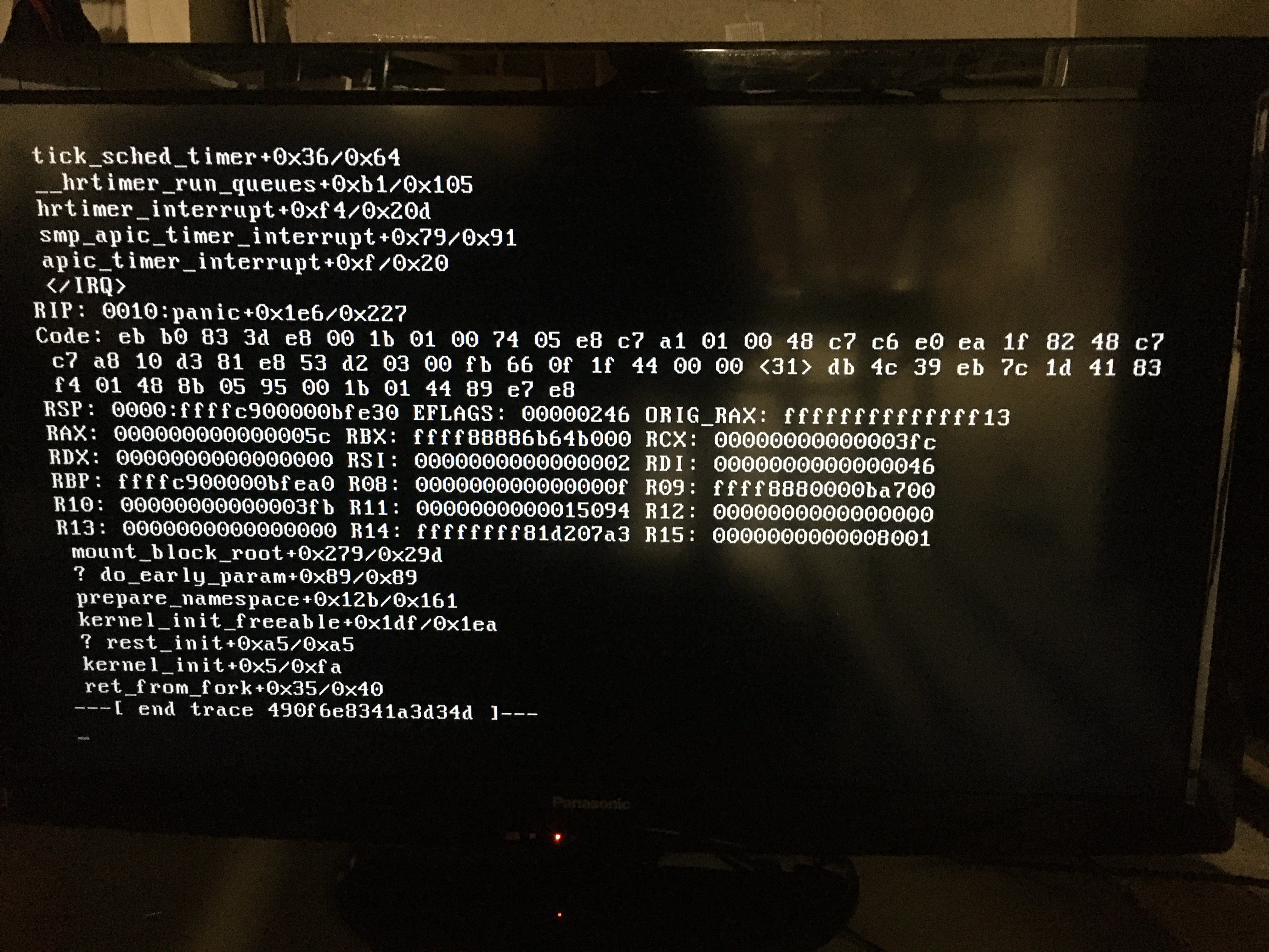

Server won't boot (Panic)
When booting the server up, the below error appears and the OS never loads. Tried both safe modes and still won't boot. Ran a memtest and no errors found.

Try re-creating the flash drive manually:
If it's not a new Unraid install backup flash drive first.
Open a command prompt window as administrator, then type, in this order:
-diskpart
-list disk
-select disk x (x=your flash drive)
-clean
-create partition primary
-format fs=fat32 label=UNRAID quick
-active
-assign
-exit
-close cmd window
-download Unraid release zip and extract to flash (or restore from backup)
-execute make_bootable as admin
Also be sure to boot from a USB 2 port.
Thank you both for your help. I have prepared the USB per your instructions and will give it a try tonight.
