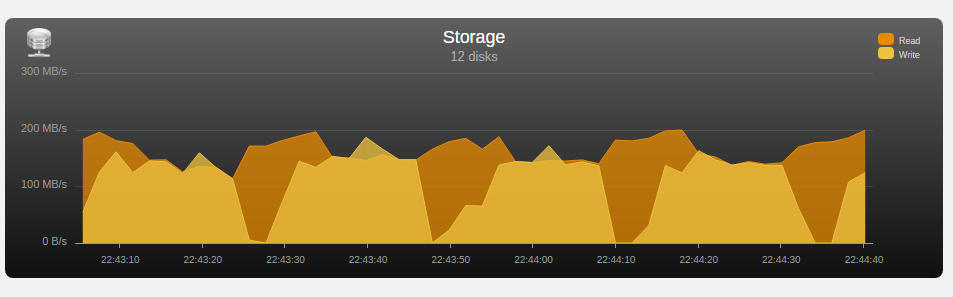

I noticed that moving files between array disks is acting a bit strangely. That is, the speed is quite fast for a while but the the move is stalled for a few seconds and then the speed starts to raise again. After a while the transfer is again stalled, and so on. Please, see the attached screen shot for further info. Is this somehow related to parity disk or is there something wrong with my setup?

That issue should be gone with v6.8, it's about to go final, though rcs are perfectly safe to use.
