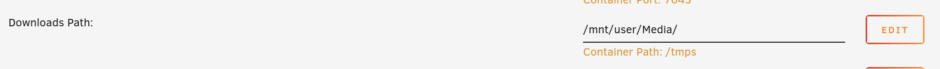

So the mapping of downloads to a docker container has always been crpytic to me, so I mapped a share in the binhex-qbittorrentvpn docker, to give it access to where all my media is. I restarted the docker container, and suddenly I get a notification that Disk2 returned to normal utilization. Somehow the majority of the media that was in that folder, all 7 or so terabytes is gone. For some reason there were a few folders left over.

If that's the only thing that happened, then qbittorent deleted the contents of its /tmps.  (Since I don't use qbittorent, I can only assume that due to whatever settings you had in it, it was supposed to)

Going forward though, on any given path you're mapping to a container, you can give it read-only access to the path so that it's impossible for it to make any modifications at all to the share (hit the edit button), but this may not be desired behaviour for the share in question
