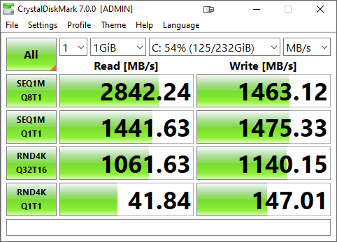

Windows client SSD Benchmark

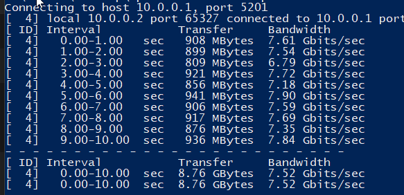

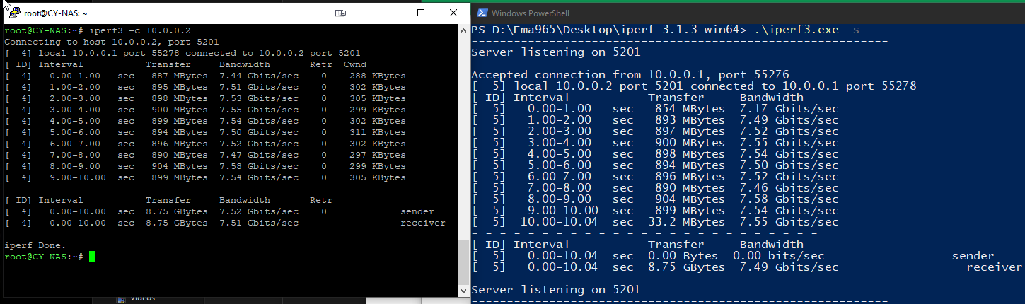

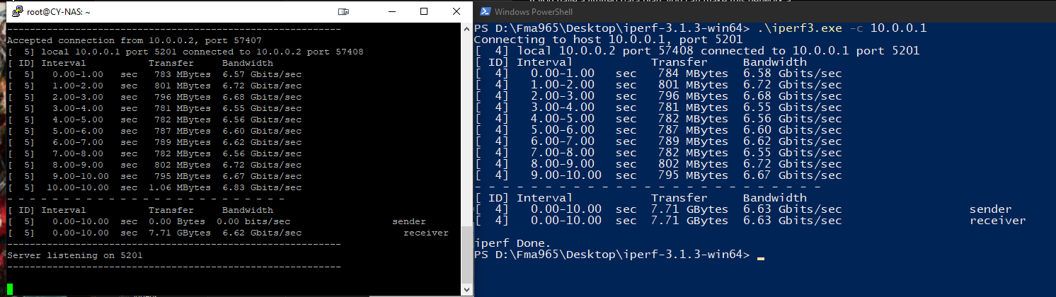

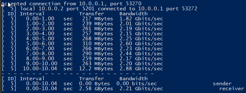

iperf has the same
When unraid is the server "-s" i get this
When my PC is the server "-s" i get this
I'm running out of ideas on what the issue could be.
Do you have jumboframes on or off? i've tried with both.
4 minutes ago, Fma965 said:
iperf has the same
OK, so the problem is network related, if iperf doesn't get more than 2Gbits, neither will any single transfer, you need to try different things, like NIC, another PC, etc until iperf performs normally.
