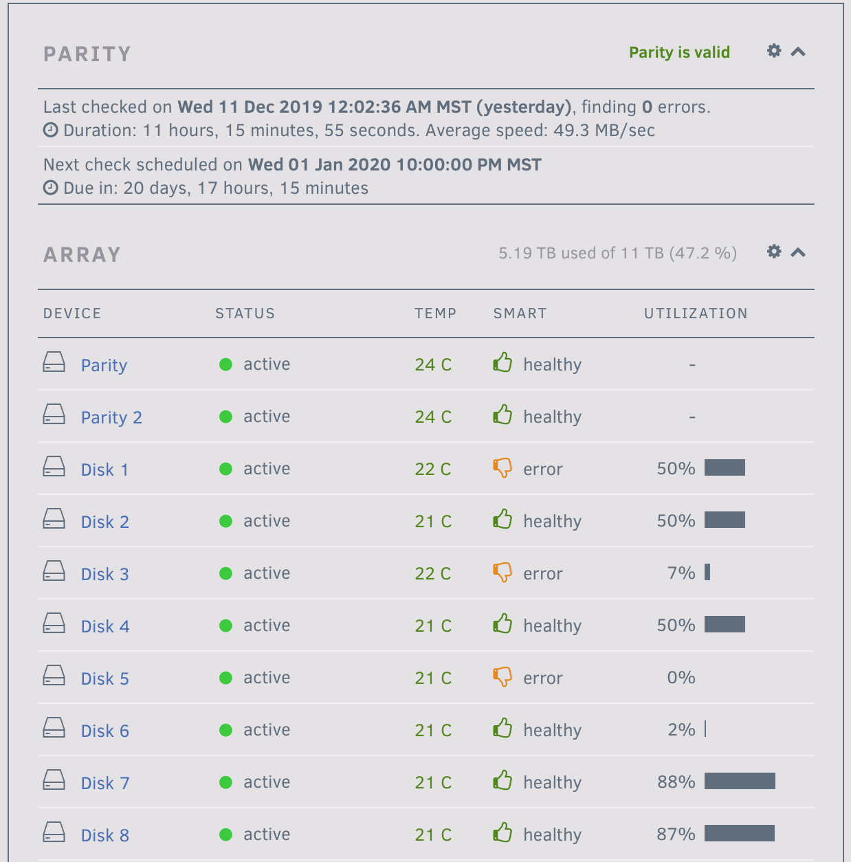

Why didn't you mention disk5 is invalid? Are you still trying to rebuild it? You have problems communicating with multiple disks so the rebuild isn't going to be good. Likely a controller issue or possibly power related.
Why do you have so very many very small disks in your array? I always recommend fewer larger disks instead of more smaller disks. Larger disks perform better and are more cost effective. More disks require more ports, probably the root of your troubles. At some point more disks requires more expensive Unraid license, you need Pro with that many disks. More disks require more power. Most importantly, more disks are more points of failure, and you have multiple failures going on right now.
I haven't looked at SMART for each of this large number of disks. Are any of your disks showing SMART warnings on the Dashboard?
Did you test any of these disks before building a server out of them?
Post a screenshot of Main - Array Devices.
Forget about trying to actually use your server for dockers or anything else until you get these hardware problems taken care of.
Do you have backups of anything important and irreplaceable?

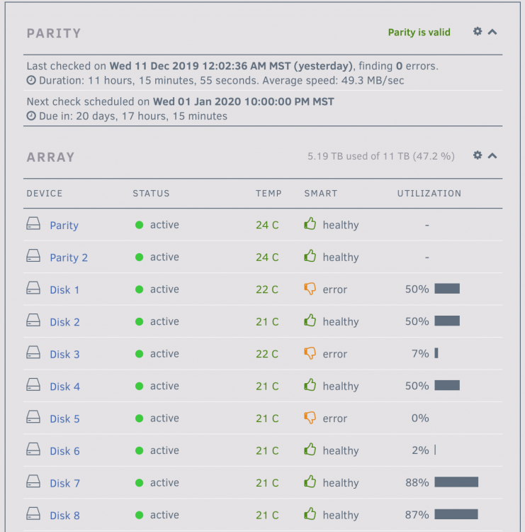

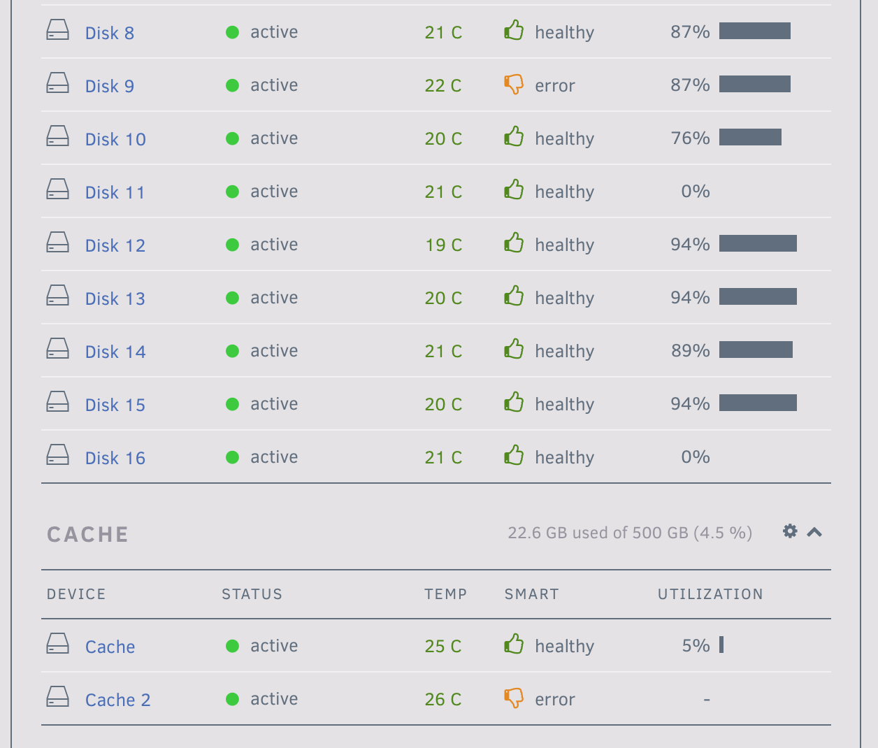

Thanks for the reply. I know the hardware is not the greatest (10+ years old) but it was free. The drives are small and old but again free. This server has been used as a backup of all the data from another new lacie server that had two brand new drives fail at once. My plan has been to go through the existing stash of drives I have kicking around from years past before I spend the money on new ones since I have had bad luck on new drives failing and I don't want to spend the money on them right now.
There are some SMART warnings and I have attached screen shots from the dashboard array.
I do get a lot of "UDMA CRC error rate" warnings but only on certain drives. I have changed out cabling on those ones and the counts have dropped considerably but are still coming.

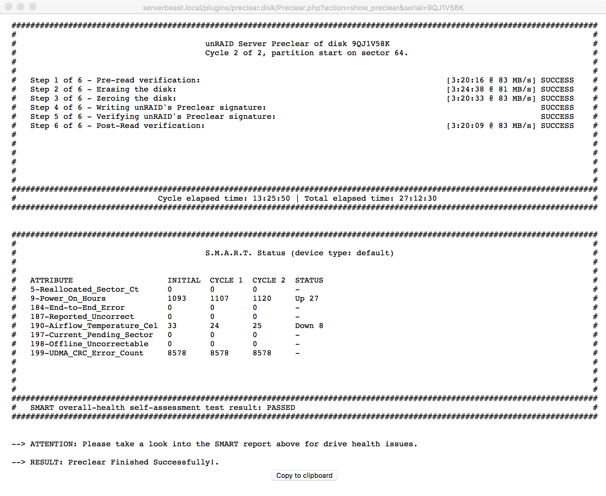

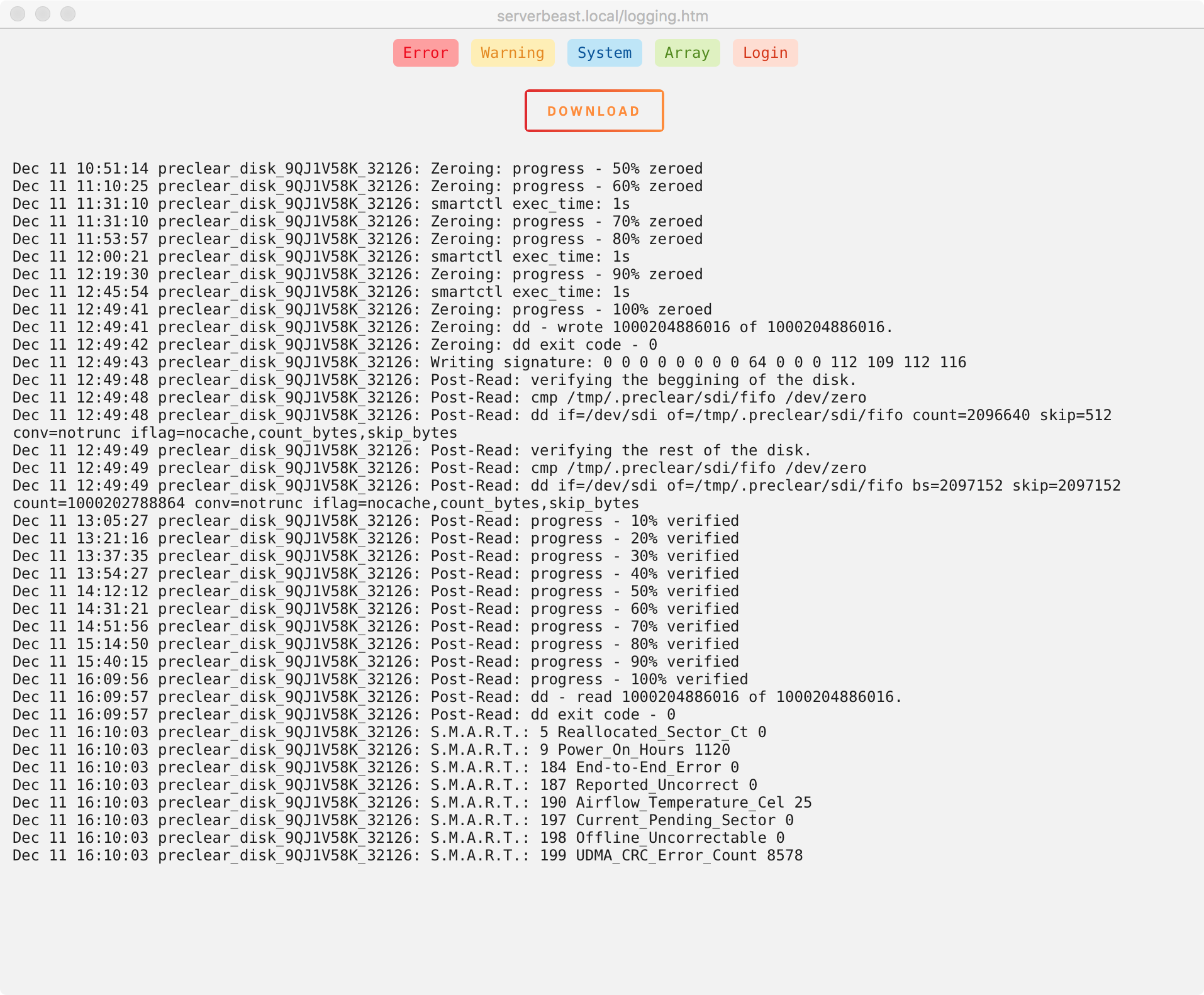

I did not test the drives before building the server. I am now starting to do preclears on all the drives I add from here on out. I just did a preclear on a used drive and have attached screen shots. Thoughts?

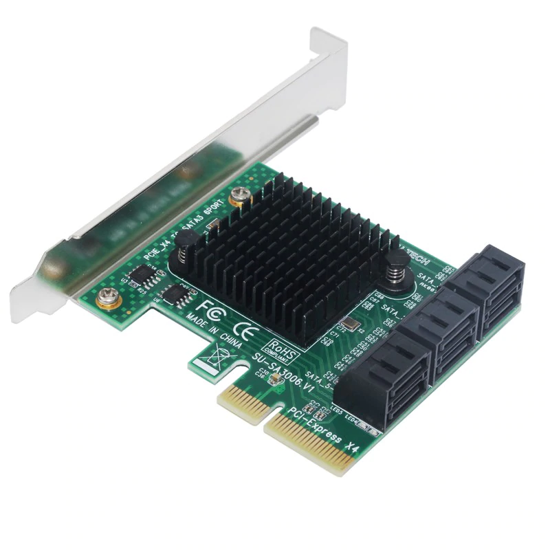

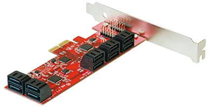

It exists in 6 and 10 port models, and they look the same on the syslog, they usually look like this (respectively):
8 minutes ago, johnnie.black said:
I really appreciate the input. It's the first picture. What would be a recommended replacement?
Those are usually communication problems, but the counts will not reset even if you fix the problem. You can acknowledge these on the Dashboard and they will not give another warning unless the count increases.
Other than those it just looks like a few Runtime Bad Blocks on each of those disks giving warnings.
