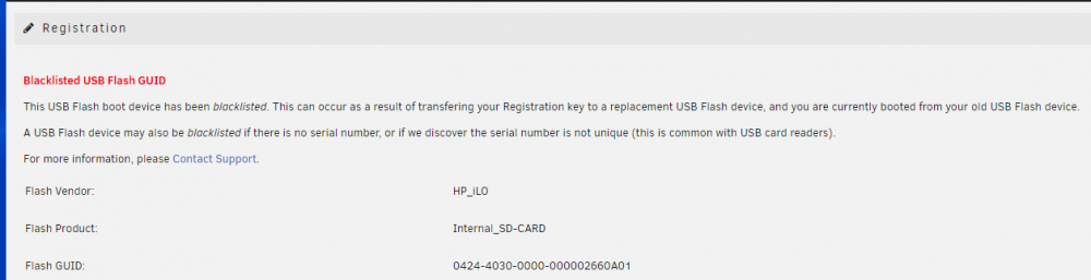

HP Gen8 Blacklisted USB Flash GUID
Learn about unraid and want to install it on my gen8 for trial and purchase, but after the unraid is installed in my built-in TF card and started, the system prompts blacklisted USB flash guid, how to solve it? When is Chinese support available?
You will have to use a different flash drive to install Unraid.
Thank you for your reply. My built-in USB slot is blocked by the graphics card. I don't want to use the TF card to boot the external USB disk. If I can't build in the boot, I can only regret to give up using unraid.
It is a requirement that the Unraid boot device have a unique GUID and it appears that is not the case for the TF card built into your system.  Most motherboard's have additional USB connector that can be used with a suitable adapter.
