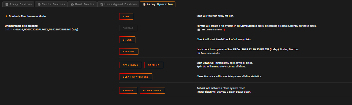

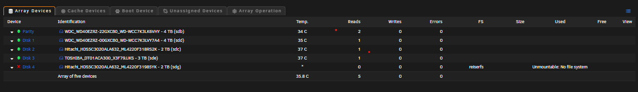

I replaced the parity drive with a new 4TB drive as well as disk 1 with a new 4 TB drive as the original disk 1 was having smart disk failures.  I followed the steps on the Wiki to replace the parity drive, this completed in about 12.5 errors.  I then replaced the disk 1 with the other new 4TB drive.   This took just over 10 hours.

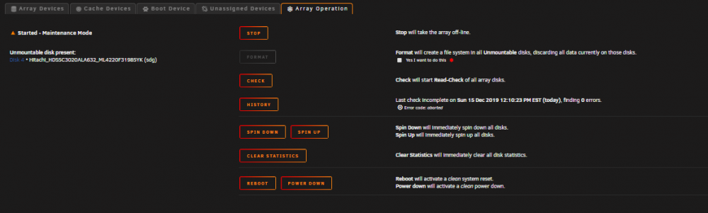

When I attempted to bring the array back up, disk 4 is now unmountable.  This was a surprise as there was never an issue with this disk.  I put the array in maintenance mode, and ran a disk check in the gui for disk 4.   There were errors and it recommended to run reiserfsck rebuild tree.  I did but no change.  Not sure how to get of this mess.
I've attached the logs and screen shots.  Running  Unraid 6.6.7.  Any help would be appreciated.
