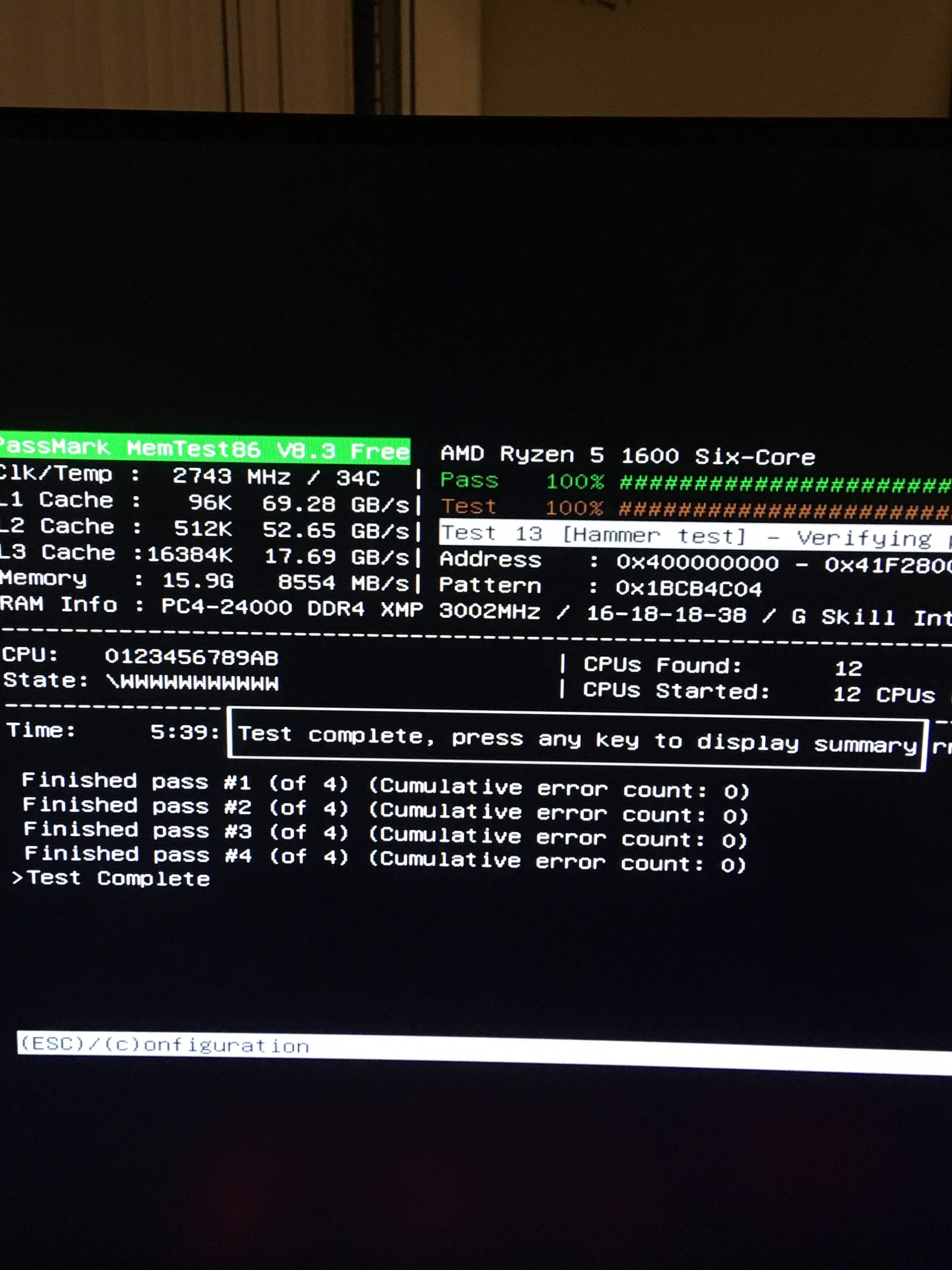

Unraid is crashing a lot, the HBA also stops responding, start by checking RAM with memtest and trying a different PSU if available.
Okay, started memtest this morning I will report back the finding after a full test. Thanks
Memtest completed 4 passes no errors found (sorry for crappy phone pic). Is there anyway to check the power supply without just buying a new one?
