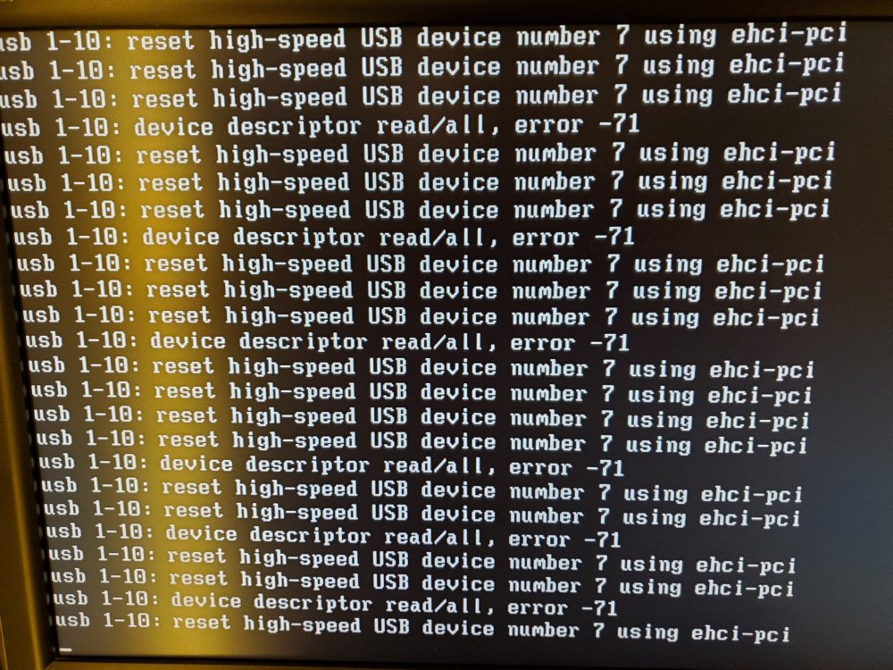

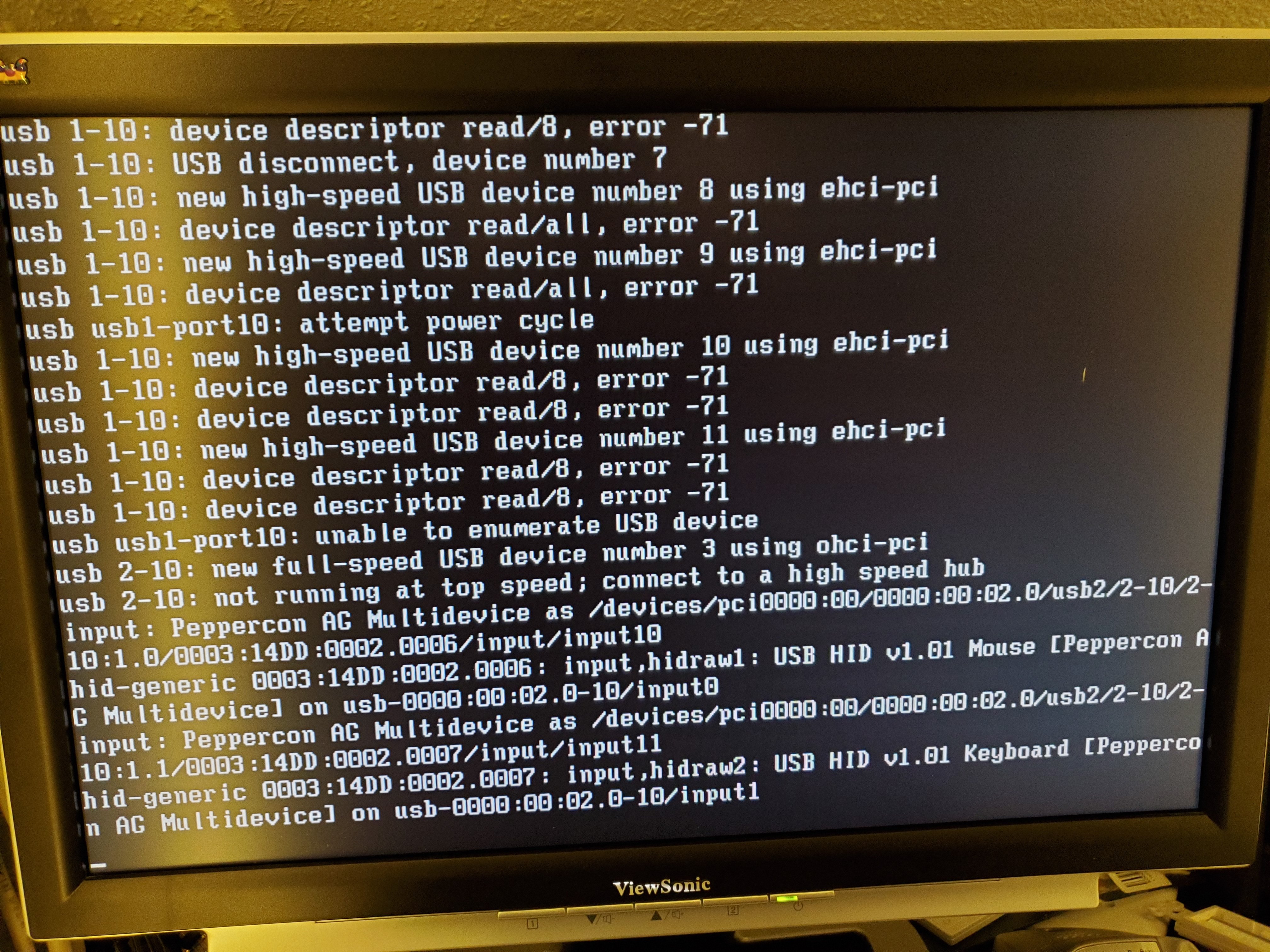

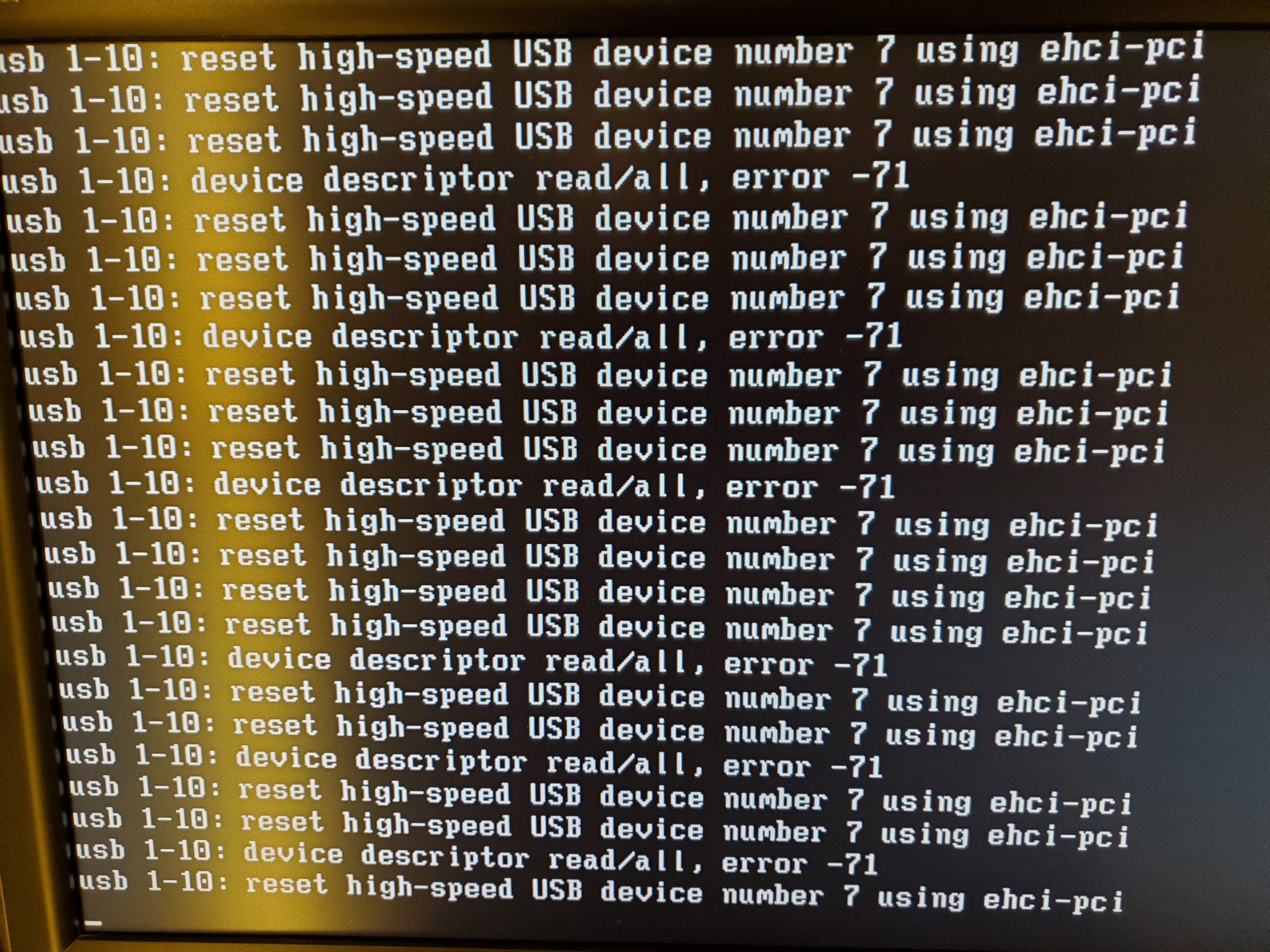

Yes I was but tried it as you suggested.  Kept receiving an error that would not clear during boot sequence and would finally stop.  I took some pictures of the screen to try and help.  Attached are the pictures of the error and then where the boot sequence stopped.  Shut down the server, removed the drive and restarted without any difficulties.  Definitely does not like the drive.  Thanks again for your help.  I really appreciate it.
Did you see the Unraid boot menu?
Are you connecting the SSD via a USB connection?
Yes the errors started after.

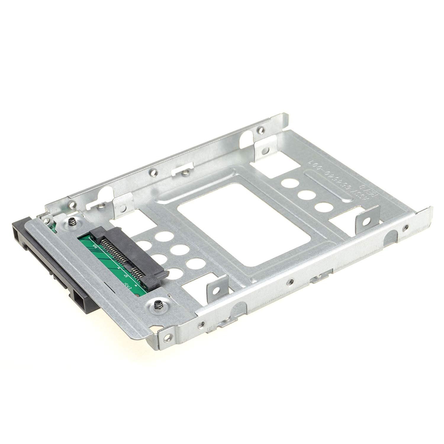

No, I found that error to be weird.  The drive is plugged into a 2.5" to 5.25" adapter then secured to the carrier tray, then plugged into the backplane.  This is the adapter I am using.
