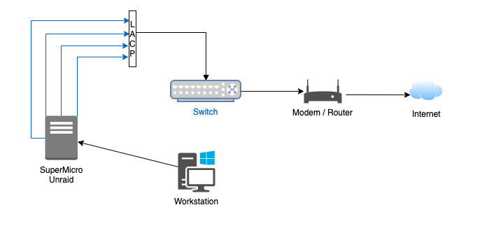

Hi Craig. Just a few questions around some of the assumptions I've made.
Does the above represent what you're trying to achieve?
Yes exactly.  However the switch handles LACP (HP 1810-24G J9803A).

Where’s your DHCP coming from ? Don’t think your workstation would get any assignment plugged in like that.
Is your desktop machine running Windows?
Just trying to think this one through
DHCP on is coming from the router.  However, the unRAID server is on a static IP as is the PC.  So I don't think the PC would need to pull a DHCP as long as it's static.  DNS is assigned at the unRAID server and specified at the PC as well.
PC is running Windows 7.

Shot in the dark here, but you could try bridging all the interfaces under
Settings > Network Settings
Then set a static IP on the Unraid SuperMicro NIC.
Then set your PCs gateway to the IP set above.
No idea if this will work but worth a shot :)
