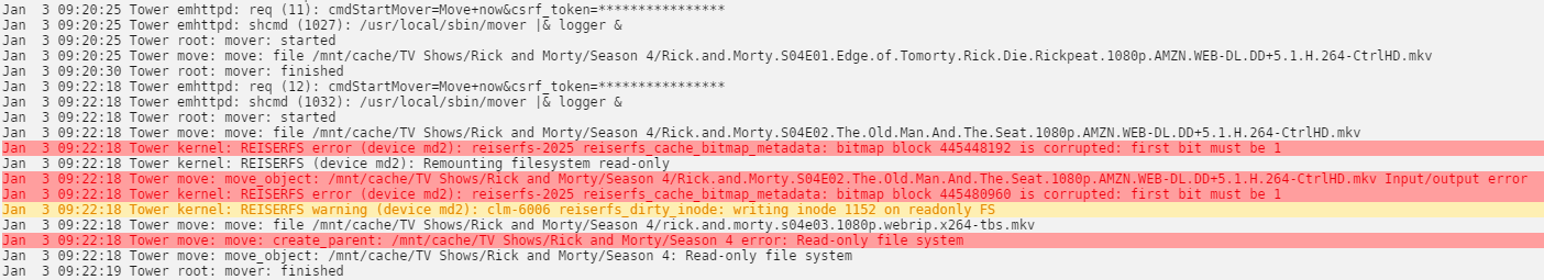

Here is an excerpt from the syslog of the last couple of manual triggers of the mover:

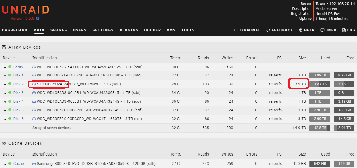

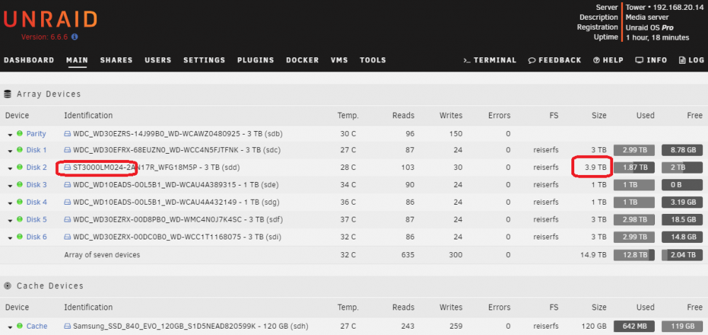

What is most strange though, is that the dashboard reports the drive as being bigger than it actually is (3.9Tb instead of 3Tb):
If you see my link above, Unraid previously identified that drive's capacity correctly.

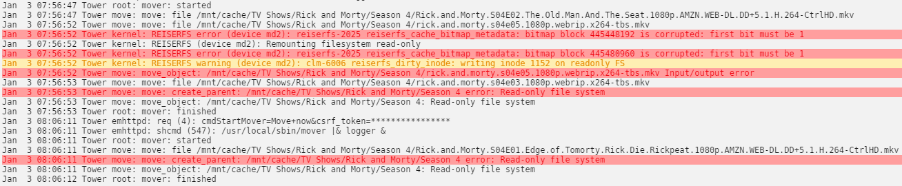

Just for laughs I tried again, and to my surprise a file moved successfully.. so i tried a second time and got some new errors:
