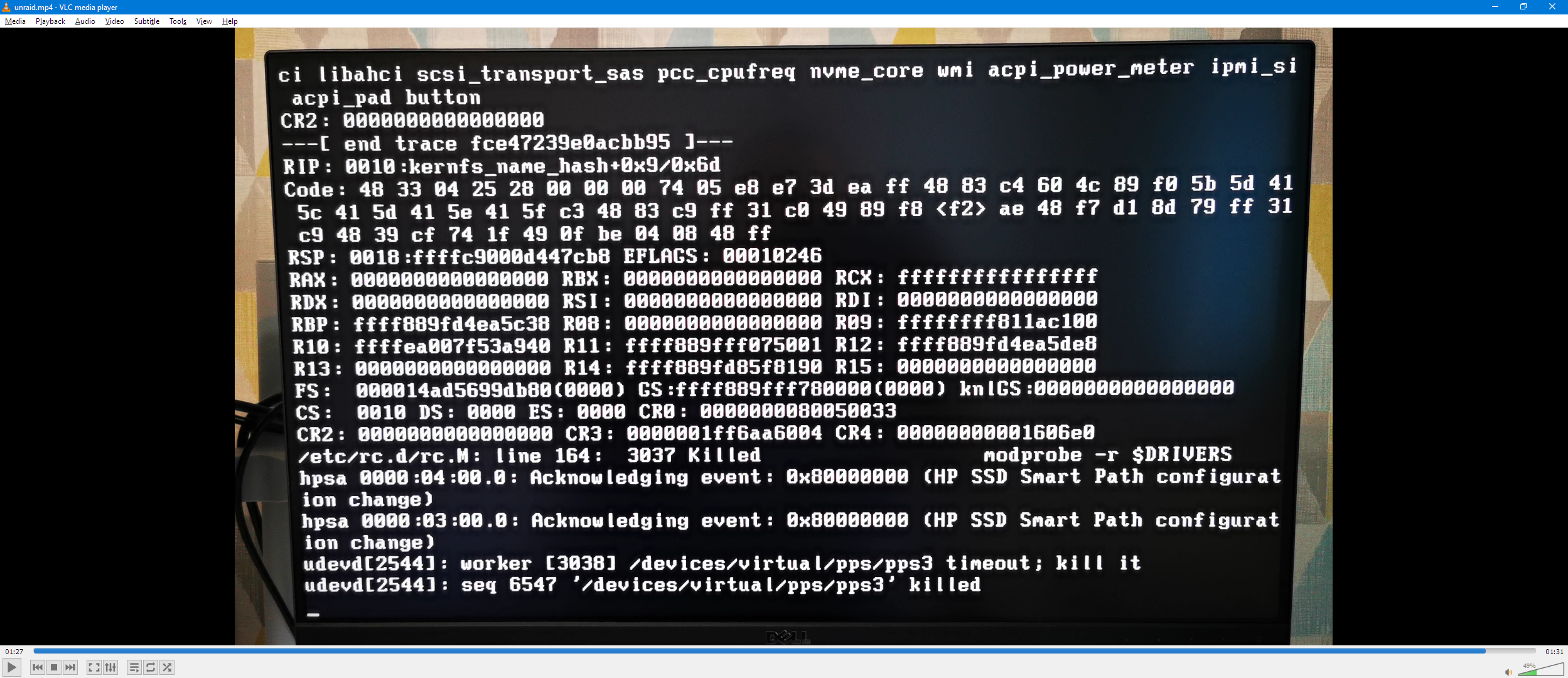

I have been running 6.8 stable for a couple of weeks with no problems. Last weekend, after adding some nzbs to sabz, I noticed that they were not being added. I then restarted the container, however it failed to come back up. Then the dashboard hung and would not load, Main would load only the top half (disk Info) or if I scrolled to bottom of page quickly enough, it would load the reboot, mover options (but no the disk info at the top of the page). I rebooted the server, but the issues remained. I then downgraded to the previous version, and all seemed well.
Today I decided to upgrade to the 6.8.1-rc1 version, and everything appeared to go well, for about 2 hours! For that entire time I was in a Ubuntu VM with a passed through KB monitor and mouse, administering the server. Without any indication or notification the monitor screen went blank.
I then jumped on seperate PC, but could not open an ssh session nor ping it. The server still appeared to be running (i.e. it hadn't power cycled).

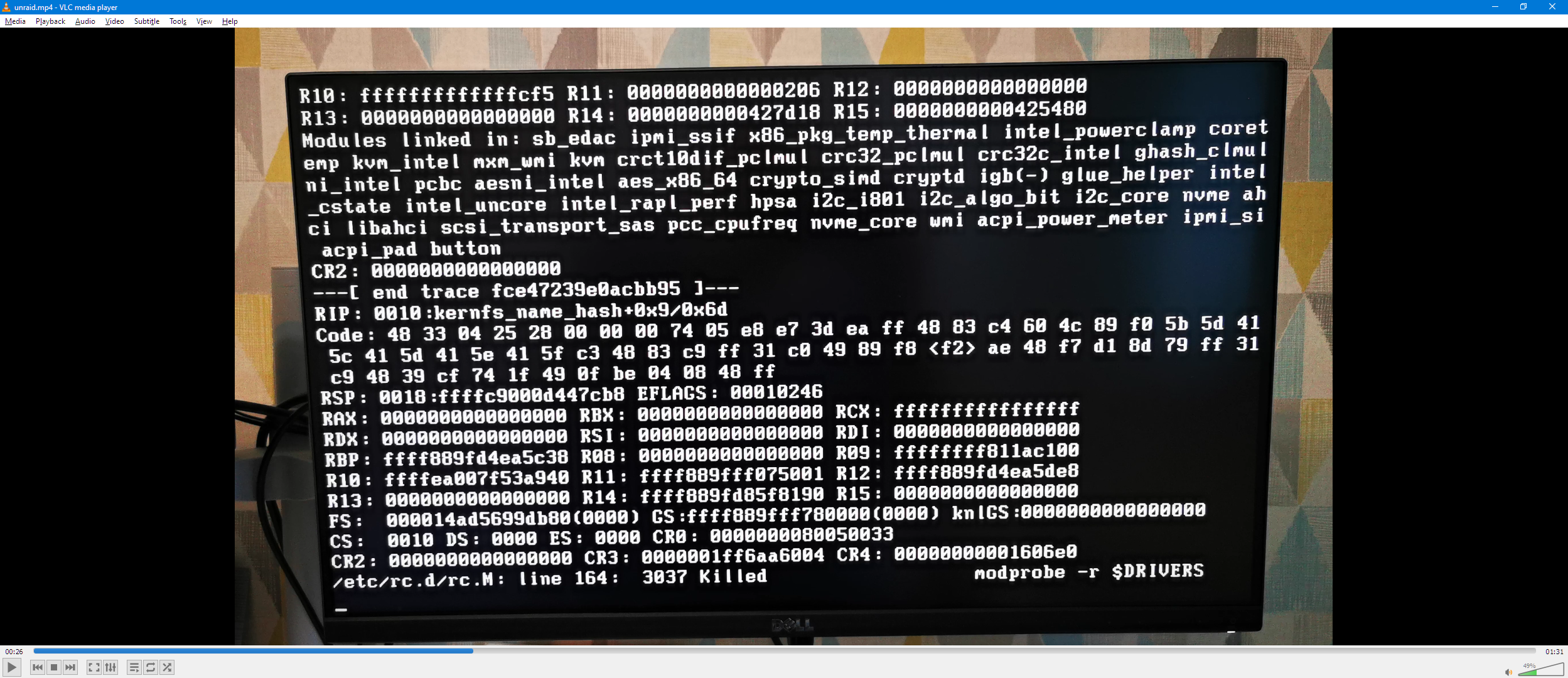

I manually fat fingered the server, and it will not reboot.  It hangs at the screenshot below (prior to this only other thing is that an unclean shutdown was detected, and dirty bit set, clearing dirty bit, as I would expect on a system crash), then once timeout is complete stalls completely after the pps3 worker is killed.
Is there going to be anything retrievable on the flas before I flatten and rebuild (obviously no logs due ot crash and restart/hang)?

So to add to my misery, after three attempted restarts and three failures, I left to put a load of washing in, came back, restart number 4 and it appears to be good with everything back to normal and currently enjoying a parity check.
