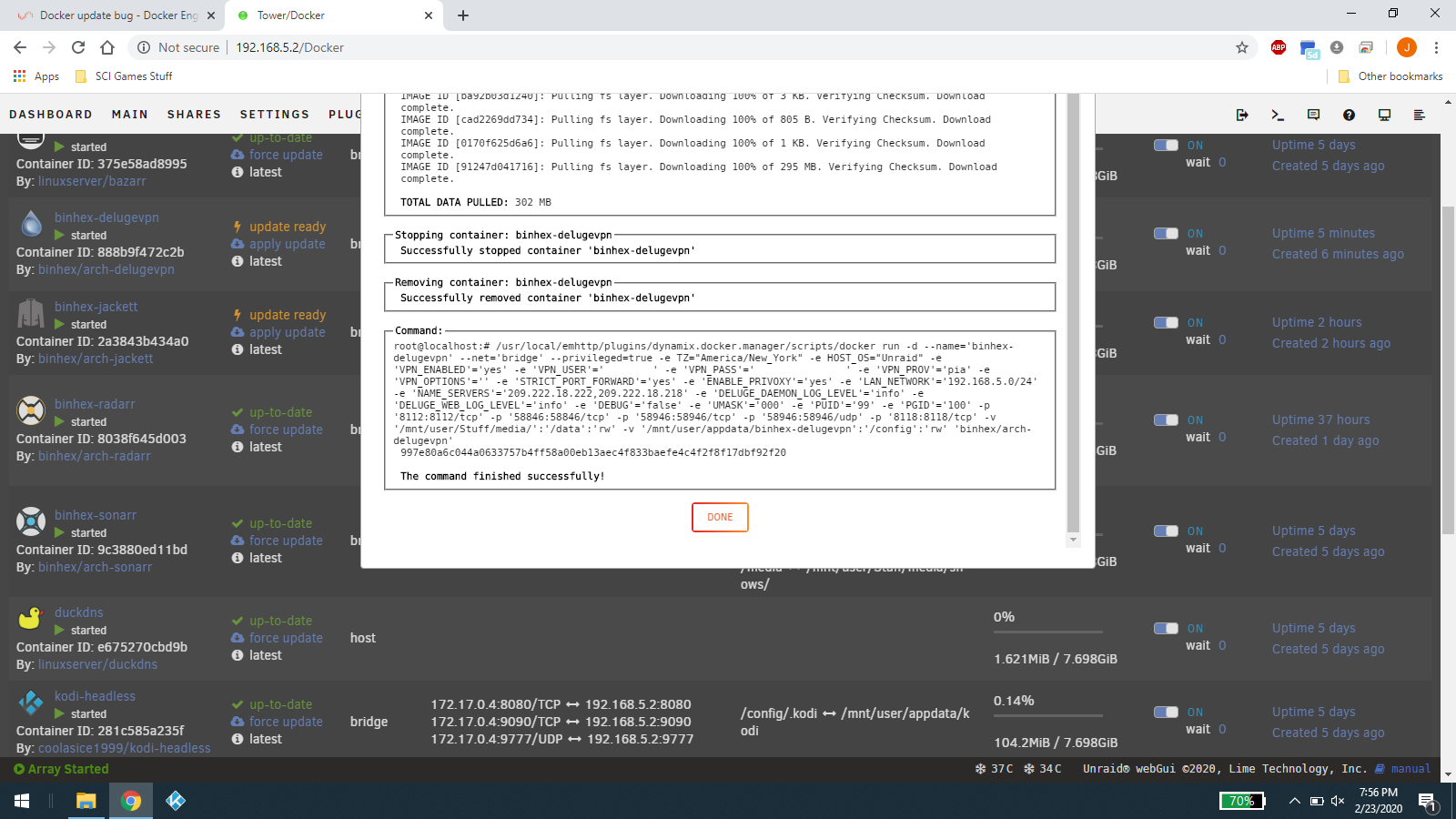

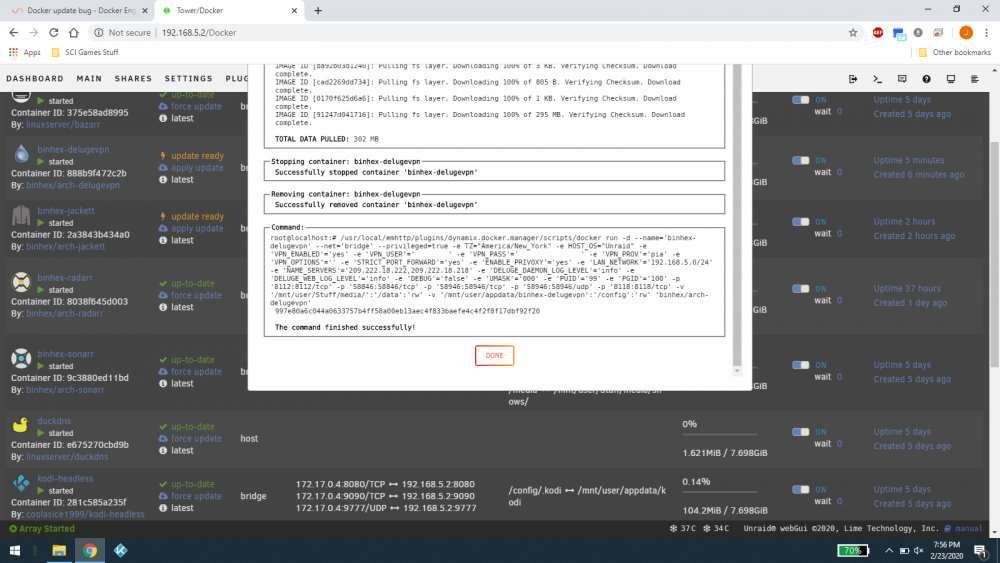

@Squid I have 6.8.2 installed and still have the docker update problem.   binhex-delugevpn, binhex-jackett, and openvpn-as dockers all show as update available....   i run update, says docker updated yet update still available?  I just rebuilt the docker.img a week ago for this same problem. Any ideas?

Can you post a screen shot of the popup that happens when you hit update

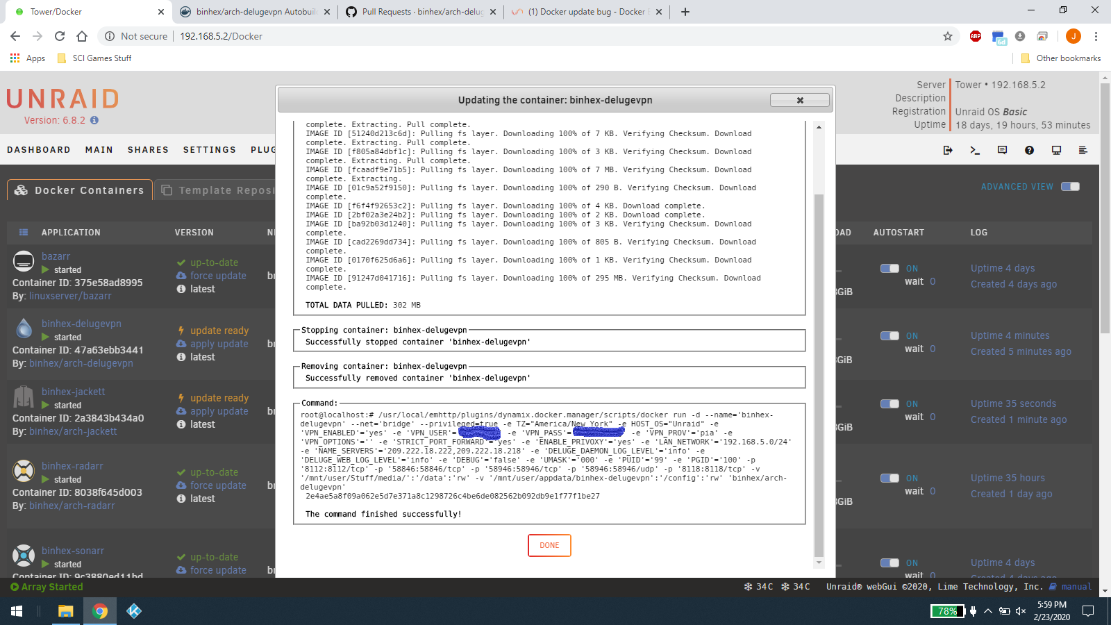

here it is.  not sure what's going on.
Edited by coolasice1999
So do it again, with another screen shot and your diagnostics
