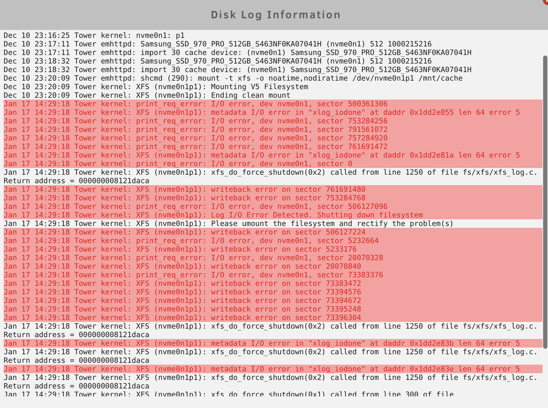

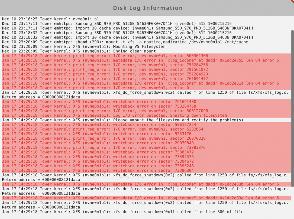

NVMe cache device stopped responding:
Jan 17 14:26:44 Tower kernel: nvme nvme0: I/O 991 QID 13 timeout, aborting
Jan 17 14:26:44 Tower kernel: nvme nvme0: I/O 992 QID 13 timeout, aborting
Jan 17 14:26:44 Tower kernel: nvme nvme0: I/O 993 QID 13 timeout, aborting
Jan 17 14:26:44 Tower kernel: nvme nvme0: I/O 994 QID 13 timeout, aborting
Jan 17 14:26:45 Tower kernel: nvme nvme0: I/O 827 QID 5 timeout, aborting
Jan 17 14:26:45 Tower kernel: nvme nvme0: I/O 406 QID 10 timeout, aborting
Jan 17 14:26:45 Tower kernel: nvme nvme0: I/O 407 QID 10 timeout, aborting
Jan 17 14:26:45 Tower kernel: nvme nvme0: I/O 408 QID 10 timeout, aborting
Jan 17 14:27:14 Tower kernel: nvme nvme0: I/O 991 QID 13 timeout, reset controller
Jan 17 14:27:45 Tower kernel: nvme nvme0: I/O 8 QID 0 timeout, reset controller
Jan 17 14:28:48 Tower kernel: nvme nvme0: Device not ready; aborting reset
Jan 17 14:28:48 Tower kernel: nvme nvme0: Abort status: 0x7
### [PREVIOUS LINE REPEATED 7 TIMES] ###
Jan 17 14:29:18 Tower kernel: nvme nvme0: Device not ready; aborting reset
Jan 17 14:29:18 Tower kernel: nvme nvme0: Removing after probe failure status: -19
Jan 17 14:29:18 Tower kernel: print_req_error: I/O error, dev nvme0n1, sector 500361306
Reboot or power/cycle to see if comes back online.

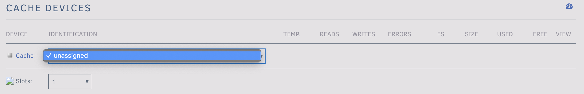

I think you are right, I rebooted and it is no longer being detected..
I will shutdown and see if the bios can detect it... I hope it didn't died because its pretty new
Not sure what happened but it’s working now. I reboot it, Bios detected the nvme, but I updated the bios just in case. Works fine now. Appreciate your help!
If it happens again you can try disabling power states, some devices have issues with those and linux, don't have the procedure at hand but post back here if needed.
Ok I will keep that in mind, will update again if this issue persists in the future... thank you!
