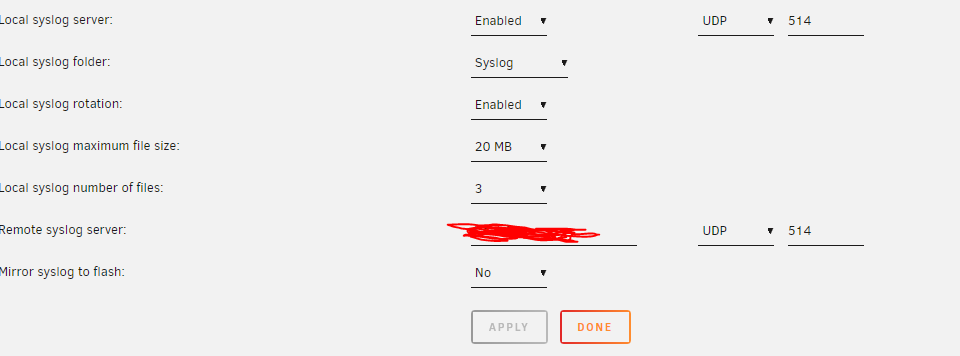

February 1, 20206 yr Hi, I've setup syslogging both remote and to a share, it appears not to be doing any logging at all, have i missed anything? Im on unraid version 6.7.2 No log files appears in the syslog share, no remote logging is being received from unraid system either. Do i have to restart the syslog service via cli? Or restart the entire system? The temporary syslog in /logging.html seems to be getting messages: Quote Feb 1 05:24:40 NAS sSMTP[2731]: Sent mail for [email protected] (221 2.0.0 closing connection y2sm5558643ljm.28 - gsmtp) uid=0 username=root outbytes=452 Feb 1 06:00:43 NAS ool www[21297]: /usr/local/emhttp/plugins/dynamix/scripts/rsyslog_config Feb 1 06:00:45 NAS rsyslogd: [origin software="rsyslogd" swVersion="8.1903.0" x-pid="21580" x-info="https://www.rsyslog.com"] start Feb 1 06:00:48 NAS ool www[21297]: /usr/local/emhttp/plugins/dynamix/scripts/rsyslog_config Feb 1 06:00:50 NAS rsyslogd: [origin software="rsyslogd" swVersion="8.1903.0" x-pid="21633" x-info="https://www.rsyslog.com"] start Feb 1 08:22:45 NAS kernel: mdcmd (501): spindown 7 Feb 1 08:23:09 NAS kernel: mdcmd (502): spindown 5 Feb 1 08:23:42 NAS kernel: mdcmd (503): spindown 10 Feb 1 08:23:45 NAS kernel: mdcmd (504): spindown 9 Feb 1 08:23:51 NAS kernel: mdcmd (505): spindown 8 Feb 1 08:24:07 NAS kernel: mdcmd (506): spindown 1 Edited February 1, 20206 yr by je82
February 1, 20206 yr Author 3 minutes ago, testdasi said: What did you put in the "Remote syslog server" line? ip address to a remote syslog server on the same lan that has port 514 udp open for incoming messages
February 1, 20206 yr If you want Unraid to write syslog to a local file on the Unraid server then the remote syslog server line should be the IP address of that same Unraid server.
February 1, 20206 yr Author 1 minute ago, testdasi said: If you want Unraid to write syslog to a local file on the Unraid server then the remote syslog server line should be the IP address of that same Unraid server. thanks, i though you could have a remote syslog + logging to a share at the same time to create some kind of backup of the logs in case unraid goes down and you cannot access content on the shares. i will setup a job on a server that mirrors the logfile created in the share essentailly giving me the same feature, thanks for the help!

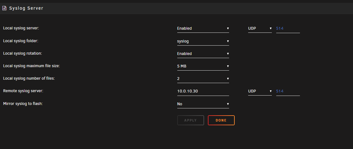

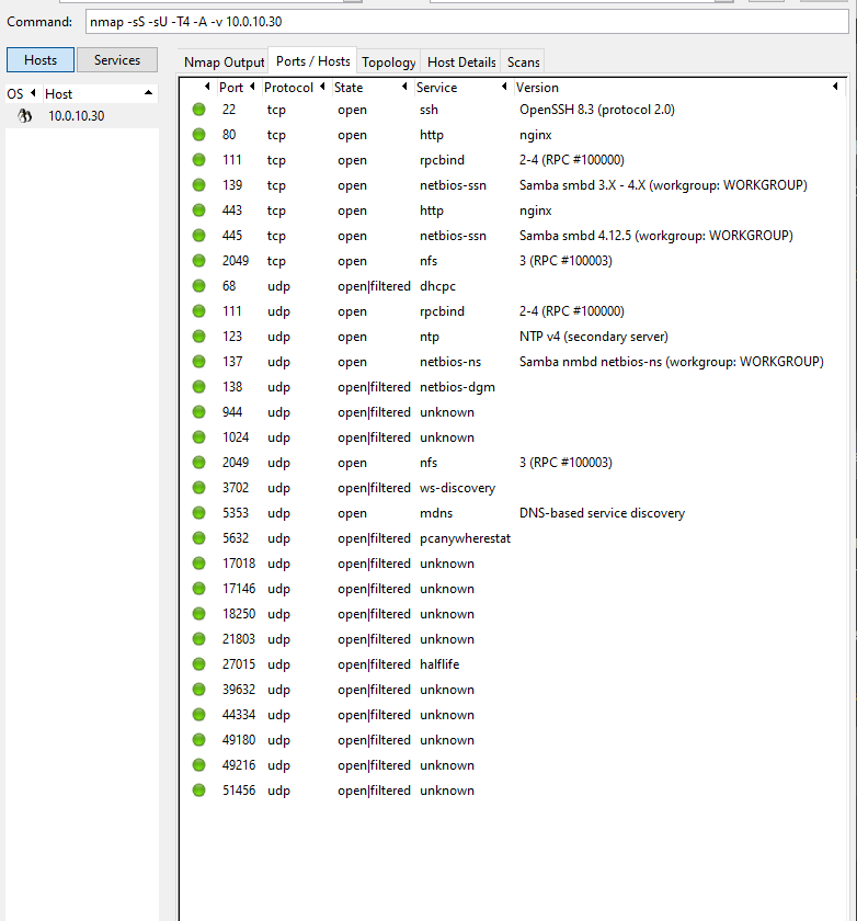

August 4, 20206 yr I just turned on syslog on my UNRAID, I set the remote logging to the IP address of my unraid system, I stopped the array and rebooted (because I was not getting any logs). I did a diagnostic dump and saw error messages stating that there was possibly network connectivity on udp port (though the port is not listed but since the syslog is set for 514 that is what I figured isn't open on the unraid server). Aug 3 18:53:54 Shark-Dive rsyslogd: omfwd/udp: socket 5: sendto() error: Network is unreachable [v8.2002.0 try https://www.rsyslog.com/e/2354 ] I ran an nmap against my unraid server IP and it shows the server is not listening on UDP port 514. How can I get udp 514 listening on my unraid server? shark-dive-diagnostics-20200803-2009.zip Edited August 4, 20206 yr by SharkDiverToo updated text and added syslog settings screenshot
August 4, 20206 yr Something has gone wrong in the syslog assignment. Did you make any manual changes? rsyslogd 16070 root 5u IPv4 29802 0t0 UDP 127.0.0.1:514 rsyslogd 16070 root 6u IPv4 29803 0t0 UDP 127.0.0.1:514 rsyslogd 16070 root 8u IPv4 30876 0t0 UDP *:44122 Do the following actions to restore a default configuration and start from scratch. Delete the files "rsyslog.cfg" and "rsyslog.conf" in the /config folder on your flash device Reboot your server Configure the syslog server settings
August 4, 20206 yr I have not made any chages to the system. Was reading about the syslog and possibly using Splunk Docker to review logs (haven't set that up yet). All I did was turn on the syslog base on the information from teh forum and then wasn't seeing anything getting logged from teh server or my UniFi UDM (pointed the syslog of that to the unraid server IP as well). 7 hours ago, bonienl said: Something has gone wrong in the syslog assignment. Did you make any manual changes? rsyslogd 16070 root 5u IPv4 29802 0t0 UDP 127.0.0.1:514 rsyslogd 16070 root 6u IPv4 29803 0t0 UDP 127.0.0.1:514 rsyslogd 16070 root 8u IPv4 30876 0t0 UDP *:44122 Do the following actions to restore a default configuration and start from scratch. Delete the files "rsyslog.cfg" and "rsyslog.conf" in the /config folder on your flash device Reboot your server Configure the syslog server settings I Just performed the: Delete the files "rsyslog.cfg" and "rsyslog.conf" in the /config folder on your flash device Reboot your server Configure the syslog server settings I am still not seeing anything getting written to the syslog folder. I rebooted again after configuring the syslog. unraid is still not listening on port 514: PS C:\Windows\system32> nmap -sU -p 514 10.0.10.30 Starting Nmap 7.80 ( https://nmap.org ) at 2020-08-04 10:20 Eastern Daylight Time Nmap scan report for 10.0.10.30 Host is up (0.00013s latency). PORT STATE SERVICE 514/udp closed syslog MAC Address: 0C:C4:7A:DE:D8:A8 (Super Micro Computer) Nmap done: 1 IP address (1 host up) scanned in 0.40 seconds
August 5, 20206 yr I restarted in Safe Mode, port 514 is still shwoing as closed: PS C:\Windows\system32> nmap -sU -p 514 10.0.10.30 Starting Nmap 7.80 ( https://nmap.org ) at 2020-08-05 10:14 Eastern Daylight Time Nmap scan report for 10.0.10.30 Host is up (0.0010s latency). PORT STATE SERVICE 514/udp closed syslog MAC Address: 0C:C4:7A:DE:D8:A8 (Super Micro Computer) Nmap done: 1 IP address (1 host up) scanned in 0.43 seconds Next I deleted the rsyslog.cfg & the rsyslog.conf again, rebooted back into Safe Mode again, still not listening on UDP 514: PS C:\Windows\system32> nmap -sU -p 514 10.0.10.30 Starting Nmap 7.80 ( https://nmap.org ) at 2020-08-05 10:24 Eastern Daylight Time Nmap scan report for 10.0.10.30 Host is up (0.00s latency). PORT STATE SERVICE 514/udp closed syslog MAC Address: 0C:C4:7A:DE:D8:A8 (Super Micro Computer) Nmap done: 1 IP address (1 host up) scanned in 0.38 seconds Does rsyslog startup in Safe Mode? I went back to my Flash Drive and looking in the config directory, the rsyslog.cfg & rsyslog.conf were not recreated after deleting them and rebooting in Safe Mode. Should I be remvoing the rsyslog.local file as well? I see it contains the settings from the syslog GUI settings. Thanks for your time and assistance with this.
