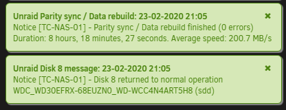

Update:
Disk 8 has finished rebuilding with 0 errors. (according to the GUI notification)
I haven't refreshed the GUI, but it's still showing that drive 8 has an unmountable file system - I suspect that may change if I refresh the GUI, but I will leave it as is and wait for your next instructions.

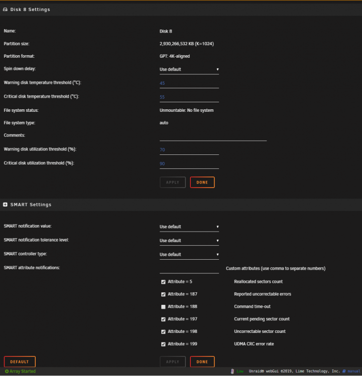

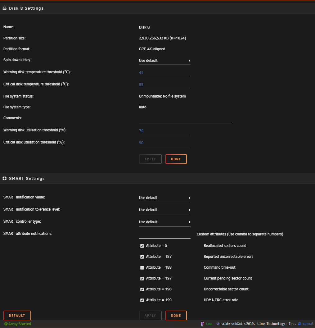

You're right - and interestingly, I don't have the option to run a check on this drive from the GUI - the menu section to do the check is missing completely:

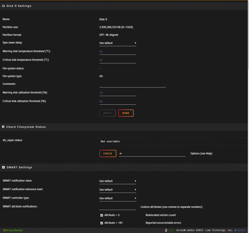

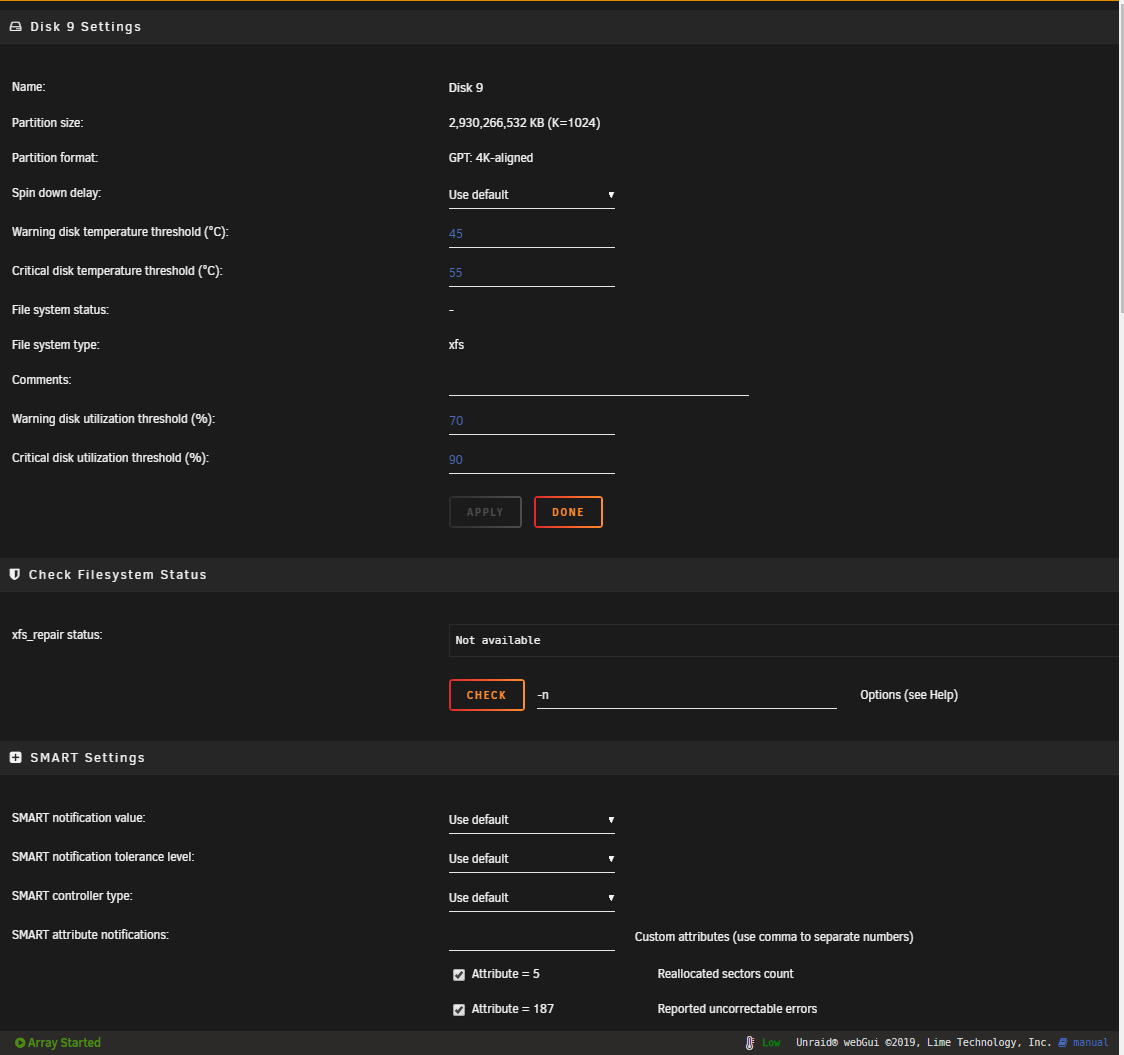

Here it's showing fine for disk 9:
Is there a way to execute a check on it now if it's showing "No file system"?
The filesystem on drive 8 was definitely xfs prior to this issue.

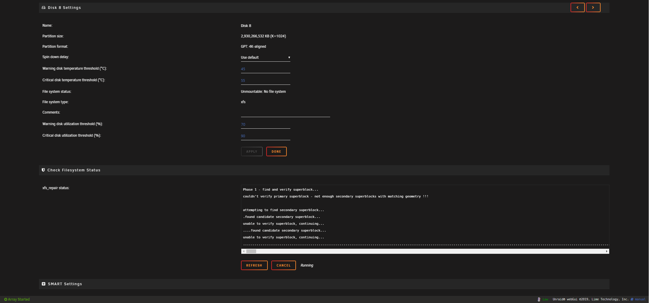

Thanks - it's running now (with -v option):
That's not a good sign, and I was afraid of that since like mentioned in the invalid slot instructions post, the disk was already unmountable before the first rebuild attempt because no superblock was found, which suggest parity wasn't 100% valid, still wait for xfs_repair to finish searching the disk for a valid superblock, but I wouldn't keep my hopes up.

Here is the output from the status pane in the GUI (minus a gazillion "."'s for readability):
Phase 1 - find and verify superblock...
couldn't verify primary superblock - not enough secondary superblocks with matching geometry !!!
attempting to find secondary superblock...
.found candidate secondary superblock...
unable to verify superblock, continuing...
....found candidate secondary superblock...
.................................found candidate secondary superblock...
.........Sorry, could not find valid secondary superblock
Exiting now.
