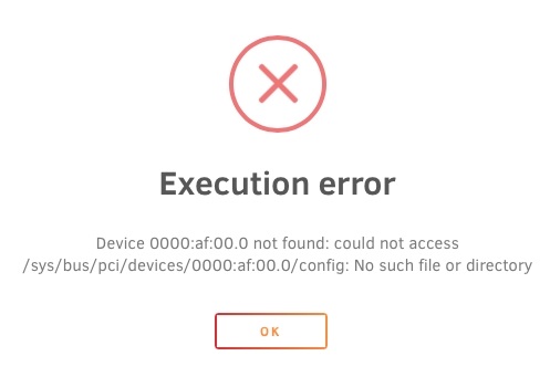

Some additional info, XML file from the actual vm as well as an error code when trying to start up.

I'd say it's a hardware issue.  Only VGA device is the ASPEED built-in controller.  Try a different slot / reseat / BIOS settings, etc
... and power.
Some GPU won't start with the the appropriate amount of power supplied and/or all the plugs plugged in.
Thanks.
That was my conclusion too. I installed water cooling on this GPU, it will interesting to see if the supplier will send a new without cost.
Power? I have tried 2 sets of cables and different PCIe slots. I will try with only one 8-pin. It is 3 cables/connectors from the GPU with is not installed. The manual or help guides says anything about where to connect. I think they are RGB light things. I have sent Asus a mail asking for instructions.
Fan connectors too! Some GPU will not start with the GPU fans disconnected.
