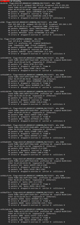

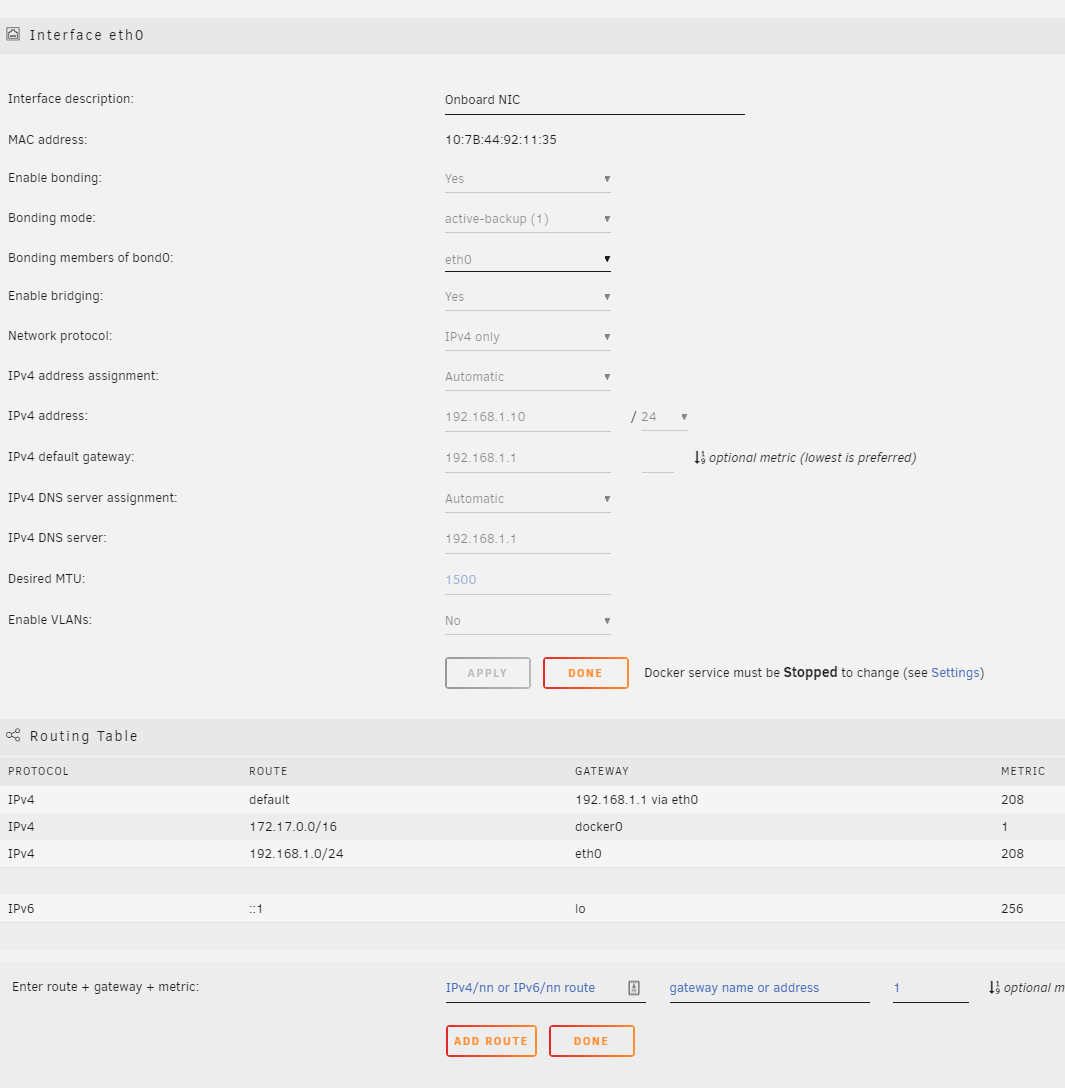

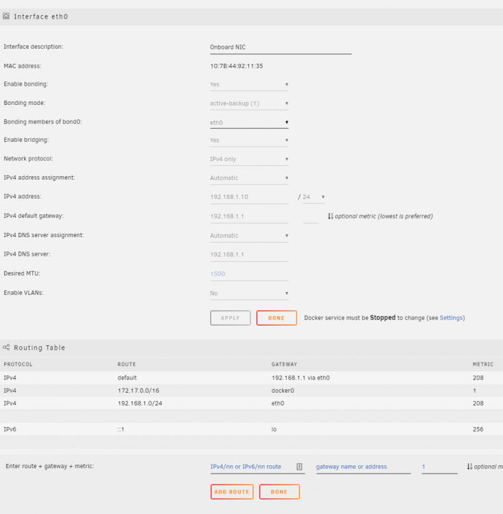

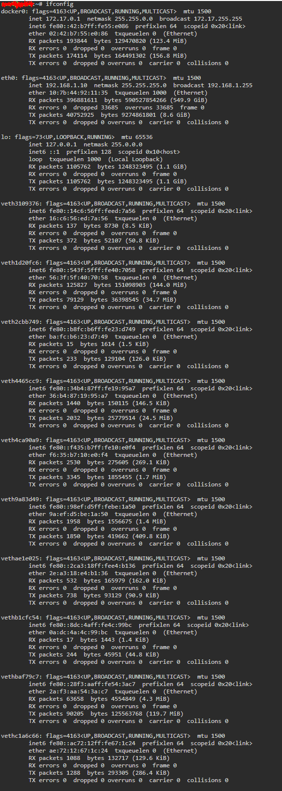

When I first went on the adventure of setting up my unRAID server several days ago I remember seeing "br0" somewhere. I don't even know if this is an important detail, but I don't see "br0" anywhere in the network settings now. Didn't know what it was and didn't care since everything I was attempting to do worked just fine and still is...for the most part. I run several dockers with no issues, but today I set out to install a Windows 10 VM that I was hoping to be able to access from my network (assigned a private IP by my gateway) and also use as a host for a Wreckfest game server accessible over the internet for my friends. Nope...
I've poked around the forums and wiki a BUNCH and have read that I need to create a public bridge in Network settings, but I haven't found any details on exactly how to do this. Help?

Have you tried turning of bonding?   It does not seem to make much sense if it only has 1 member.
I have not,  but I will try I guess. Thanks for the tip!
