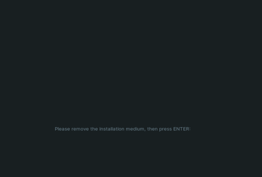

I recently started using VM's on my UNRAID Build. They work flawlessly however I find when I reboot the VM's they display the attached error, and also seem to go through the OS installation again. Could anyone advise where im going wrong :)

You can always edit the VM template and remove the Installation ISO from it.
Wouldn't this then make the VM unable to boot on next startup? I have a ubuntu VM and whenever its rebooted It reinstalls everything again causing it to use default logins etc.
If you installed Ubuntu correctly then no, removing the ISO will not stop it from booting.
In fact, you are supposed to remove the installation iso after installation.
Ahhh okay, Thanks for this info.
