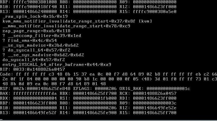

System just crashed again...
System totally unavailable, no shares, no web gui, no telnet. I can connect with IPMI , herewith what I see in the screen (see capture).
Thru the console I was able to copy syslog to /boot. Herewith attached.
I then gave a shutdown -r now.
After the gracefull shutdown time expires the system forces a shutdown, this also does not succeed and the system "hangs" for several minutes. At what time I use the physical off switch to have the system reboot.
I will reboot again... This has been going on for several weeks... Sometimes it keeps running for a few days, sometimes a week.. And then again a crash...
System has been stable for -years-.. This has been happening since the last two versions (I am running the most current at the moment. It happens in and out of safe mode, no difference. To be honoust I do not know if I was running in safe mode this last crash, I might not have been, I now am again.
System has booted up and is running again.

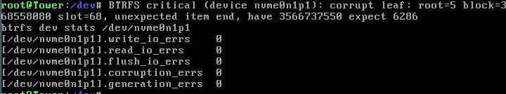

I am seeing some BTFS errors.... Running a scrub ... I see the following in the console:
BTRFS errors have not always been there though, I expect this to be more of a result of the constant crashes then a cause..
I think I will need to run a fsck..
Did a dev stats before:
Doing a --readonly first:

1 hour ago, Helmonder said:
Do not use --repair unless you are advised to do so by a developer
--repair can only fix a small number of issues, and sometimes it makes things even worse, you should backup any data on cache and re-format the pool, there are some recovery options in the FAQ if needed.
