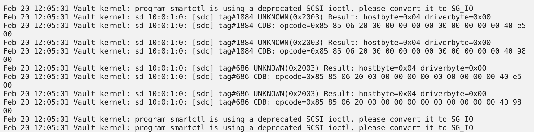

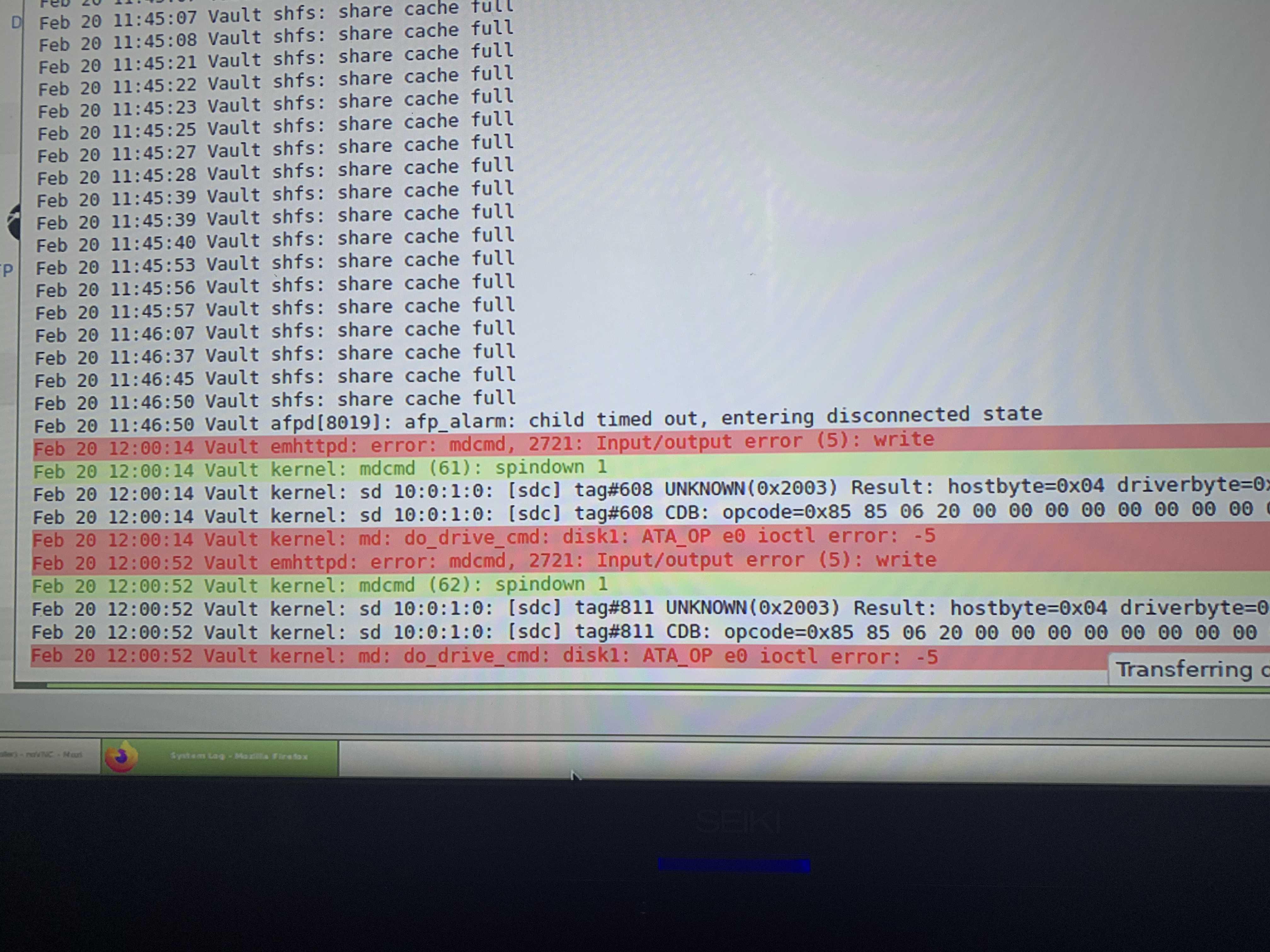

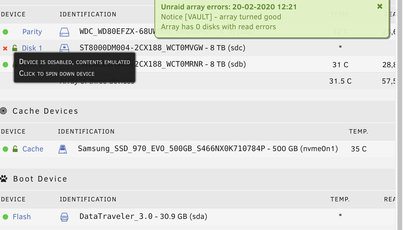

unRAID disk1 says "device is disabled, contents are Emulated", unRAID log shows these two errors:
emhttpd: error: mdcmd, 2721: Input/output error (5): write
kernel: md: do_drive cmd: disk1: ATA_OP e0 ioctl error: -5

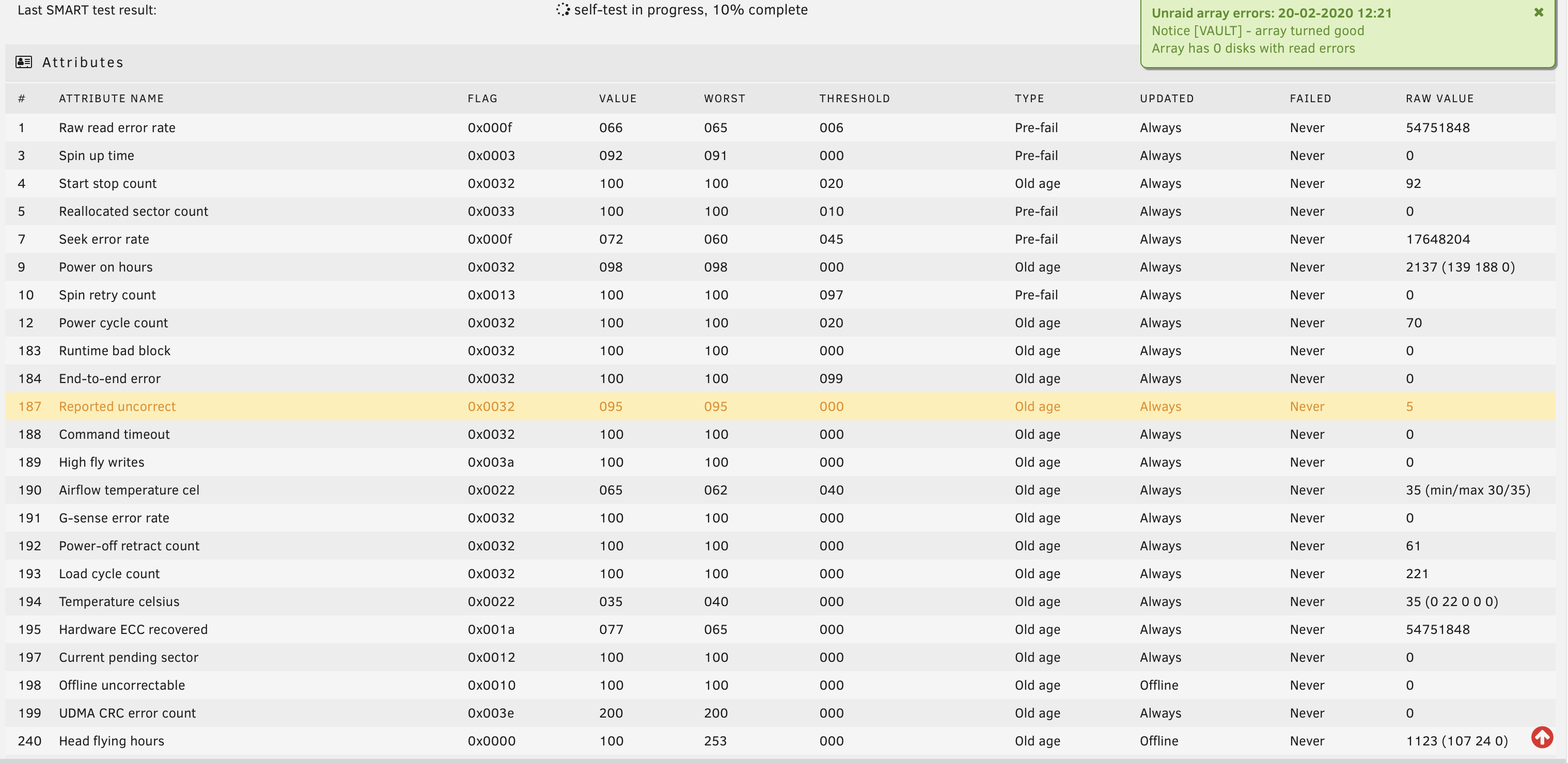

restarted, ran SMART quick test, passed, zero errors found. (I am running an extended test now, will update with results)
If I can ignore this error (which a quick google search makes me believe I can) how can I re-enable the device?

Next time please post diags instead, wait for the extended SMART test to finish, it will be the best indicator of the current disk health.
So the extended SMART test didn't finish, unRAID said it was aborted by user (it wasn't), I'm running it again, but here hare the diagnostics (fyi its disk1 (sdc) that's disabled), thanks for looking them over.
How would I enable the disk, would I have to go to Tools>New Config, remove the drive, then re-add it? (I just don't want to loose any data)

Problem appears to have been the disk, so wait for the SMART test to finish.
Correct procedure in this case would be to re-enable the drive (if SMART test is successful).
